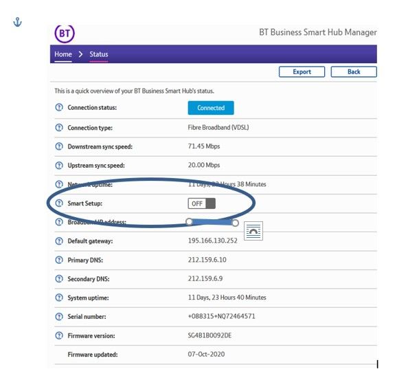

@gdgreen wrote:
There is a separate post on this, but as this thread is the most comprehensive discussion of using the BT SmartHub 6 I thought it might be worth adding here that the Business SmartHub 6 firmware no longer has a Smart Setup option, so step 4 in Baldrick1's instructions can (indeed must) be skipped. I was panicking when I could not find this option, until I googled it and found that someone else had already worked out that the option is gone and hasn't just been moved.
I agree that it's now been removed from the Home page but it's still there amongst the data on the Home Page:

Ah, that's interesting. I did not spot that setting and instead just tried skipping step 4, which seemed to work.
I've just had a look at the setting on my router and it has smart setup on, but this does not seem to have prevented the router from dealing correctly with my Plusnet service.
So, I was wrong to say that step 4 must be skipped. It would seem sensible to find it in the Status page and switch it off, just in case. But in my case it doesn't seem to have mattered that smart setup was on when I connected to the phone line.
I've switched it off now, just in case it causes a problem in future (eg, firmware reboot)

@gdgreen
I had a mental block saying it has been moved from the home page to the home page. As you have picked up from the screenshot I meant it has moved to the Status page. The edit window has closed so I guess it's stuck that way now.
It shouln't cause any problems leaving it on, it's just that you get a page of irrelevent junk when you try to connect a new device.
