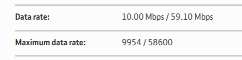

Whilst exploring the setting on my new BT Smarthub 6 on a Plusnet Account, I see these setting, which seem to imply that my download and upload speeds are limited.
Is there anyway to adjust them, to reflect the Plusnet Contract of  Fibre Unlimited  Extra, that I have been paying for, for the last 11 months?

I would double check that you are on the product you think you’re on - the hh6 just presents the data available to it.
Mine shows:
Data rate:
20.00 Mbps / 66.05 Mbps
Maximum data rate:
21663 / 67885

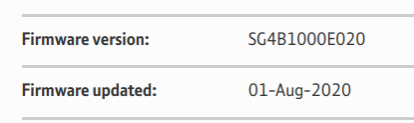

@dvorak Plusnet  Engineer just told me my line is "at its limit".  This is odd as BT offer their 900mbs FFTTP in my area and it's fibre to the top of the pole outside. Maybe it just needs a reboot or resetting as for a few days (August 2019) while being switched from Fibre to Fibre Extra it did go up to 66mbs down and 15mbs up, but since then it's been very poor?
I just thought you might like to see the difference just switching hubs has made to my Fibre Extra speeds 😀
Who knows, one day my up speed may be in double digits and as high as 10mbps again Funny
On the Plusnet One hub, ThursdayOn the Plusnet One hub, ThursdayOn the BT hub6 FridayOn the BT hub6 Friday

Registered: ‎11-04-2017
@Leapy wrote:
@SAABDude @Baldrick1 Thanks to both of you.  That is very useful information and pre-empts my proposed next question on how to update  the firm wear as I'm not with BT Thumbs_Up
I'm pleased to say I'm now up-to-date and on the radar with my BT hub6 Wink
