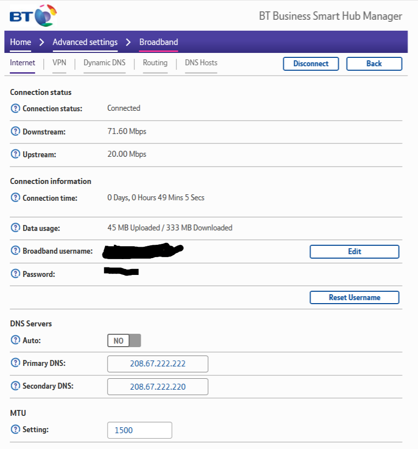

@demsley wrote:
However DNS issue persists.  I can add DNS Hosts - as per screenshot1
You are changing the wrong thing delete these.
I cannot change primary and secondary DNS - as per screenshot2.
That's because you are setting them in the wrong place. This is the page that you need, See the DNS Server section towards the bottom.:
Posts: 14,726
Thanks: 7,616
Fixes: 479
@mechanic123
As you will see from my previous post I use OpenDNS servers rather than Plusnet's. I am confused why you are stating that these tend to change and demonstrate this by posting links to Plusnet authoritative DNS servers to which access has now been blocked by Plusnet? I am not aware that OpenDNS change theirs.
