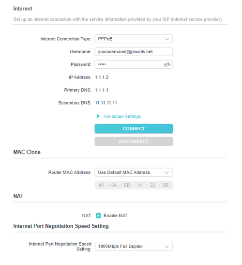

Hi everyone and thanks for all the words of wisdom. The issue I have now is I can't get the TP-link router to work with the amber "no internet" light. I have set everything as has been suggested using the correct login/password; PPPoE; cloned the mac address; but to no avail. One thing I did notice when looking at router settings on the plusnet versus TP-link web pages was the Lan IP address for TP-link was 192.168.0.1 whereas plusnet's was 192.168.1.254. Could this be something to do with it and if so, any suggestions? Thanks in advance and for tolerating my ignorance 😊

You do not need to clone the MAC address leave it Use default MAC Address. Using the TP-Link emulator, I would expect the Advanced >Internet settings to look something like this
The change of IP Address to 192.168.0.1 will not stop the Internet connection,

It won't let me add an screen shot but I can tell you that your image is the same apart from the ip adress/primary/secondarydns saying 0.0.0.0 on minen the mac address is different and the Internet port speed setting on mine is "auto" . Im a bit puzzled as it's not the cable etc, as im using all the same ones with the Plusnet router.

The IP Address are 0.0.0.0 as the broadband user has not logged on to the plusnet network.
The AX20 blue WAN port should be connected directly to the ONT, every MAC address is unique, speed Auto should is fine as the port should auto negotiate to the correct speed, probably 1000Mbps.
If you look at the System log found in >Advanced >System >System log. In log type you need to look at PPP messages. Hopefully it will give us a clue what's wrong

@Bunglebonce It won't let me add an screen shot
If you are accessing the forum from a 'mobile' type device, then you will need to select 'desktop site' from the browser menu before the ability to add screen shots will appear
I hope its not exactly then same, there's a minor typo in @Dan_the_Van s post , it should be plusdsl.net not plusdls.net
