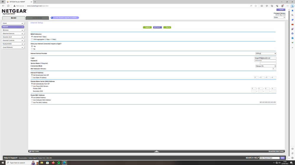

Until a few weeks ago all was working fine using a Netgear DM200 modem and a Netgear Orbi RBR50 router.
The suddenly could not access internet. So swapped out modem for another of same model, still no internet.
So connected a Netgear R8000P router still the same.
So what I would ideally like is someone who has a Netgear modem router setup to tell me what the settings should be. Years
ago I took a screenshot of the settings but of course cannot find it now.
One main question do I answer yes or no to the question asked
Does your internet connection require a login?
If yes what do I put in for login details is it [email protected] or just xxxxxxx ?
If no asks for account name but only says input if required.
Am very confused can only try so many combinations so an answer to the login or not is a good starting point

@bogart99 Yes, your connection does require a login - [email protected] and your password.
Screenshots of the setup screens would help others to help you.
Re: Using others modem/router
22-09-2023 3:22 PM
Does your internet connection require a login? Yes
If yes what do I put in for login details is it [email protected] or just xxxxxxx ? its accountname suffixed by @plusdsl.net . Password is the one you use to access the member centre https://www.plus.net/member-centre/login

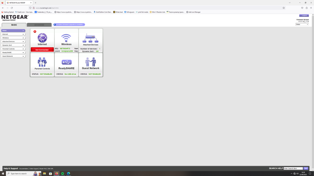

22-09-2023 3:39 PM
22-09-2023 3:44 PM
@bogart99 That all looks OK to me - can you get a connection?
22-09-2023 4:45 PM - edited 22-09-2023 4:45 PM
No as evidenced by the 2 latest screenshots. What I do not get is even though is set to capture dynamic address from Plusnet it does not as shown by last screen shot having no details for IP port.

Finally got there problem was DM200. For some reason had set itself back to Modem and Router and not just a modem.
Unsure why as nothing was switched off between it working fine and problem occurring at least if happens again I kjnow where to begin looking. Networking will never get my head around it.
