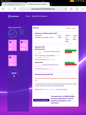

It may not be necessary to replace your Hub One, have you performed any checks?

A good starting point would be to follow the instructions here (copied from @jab1)
BT Broadband(obscuring your phone number) and BTW Performance Tester - Over a wired (ethernet) connection if at all possible, please report the 'ADDITIONAL DIAGNOSTICS', and sight of the broadband connection status from your Hub would be a good starting point.
For the Hub One -
For the Hub Two -
If phone test is OK then take the front off your telephone master socket, you may need to remove two screws. In behind you will find the test socket. Plug a filter in here and connect that to your hub. If it’s still dropping out then report a fault at https://faults.plus.net
Edit: You might have an intermittent line fault which is causing the disconnects

There isn’t a fault with the line, it’s the hub that has the issue, as one device can get internet access, but others can’t get an IP. The devices with connection to the internet keep changing. For instance, my PC connected via a LAN has Ethernet, but another device that was connected to a different LAN loses connection. Then it all changes, with smartphone connected through the DECOWiFi ( LAN4 ), suddenly has no internet, but my tablet and PC do. All devices going through the Hub One, connected to the master socket. When some devices have internet and others don’t, which varies, everything points at the hub, not the line. If they were all disconnected at the same time, then the line could be the issue, but that isn’t the case here. I wish it was, that would be easier fault find.
It won’t allow me to add the BT report, but basically, no issues.
