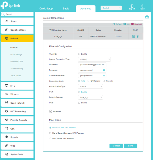

@4legsgood
Provided you have selected Wireless Router Mode, the Advanced >Network >Internet setting should look something like this.
LAN 4 becomes the WAN port and this goes to the ONT

I can't thank you guys enough. As stated I've spent a lot of time
  • Talking to Plusnet,
  • In a long online chat session with Tp-Link
  • In a long series of email exchanges with Tp-Link.
One post here and the problem is fixed - I simply needed to change the Operation Mode to Wireless Router. Again - many thanks to all who told me this was the solution.
