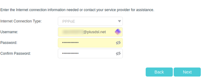

There's 3 images here. The simple login window

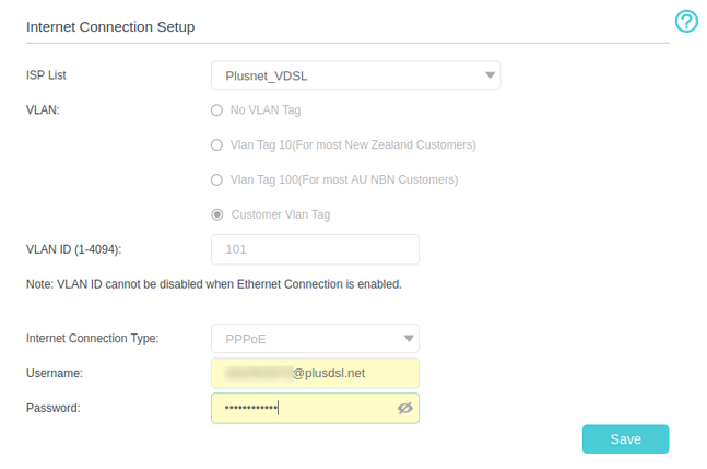

A more useful window

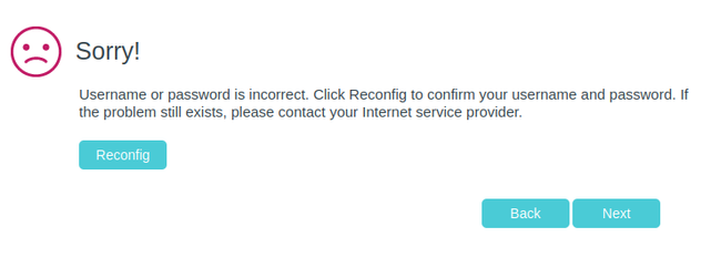

And the error message.
If I'd not checked it a million times I would say that the login details are wrong, just re-enter them. I think unless there's some other way, its a password reset

To me that error message looks like the TP Link didn't like the format of something in the username or password,
rather than reporting that a xDSL PPP login attempt had failed for some reason.
Does your Plusnet account name or password have any 'special' characters, other than the usual 'A'..'Z', 'a'..'z', '0'..'9', '-', '_'
The other thing that bothers me, is that it is telling you VLAN info about Australian and New Zealand networks.
VDSL routers and modems ARE region specific, with different line impedances, Annex A or B, and RJ11 wire pairs used, etc
Does the TP Link you have, definitely have 'UK' region makings on the device label, and/or packaging ?
