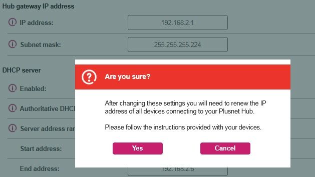

I'm sure I'm not being totally daft here.
I can change the subnet to a /26
I can change the subnet to a /27
I can change the subnet to a /29 (which is what it is currently running with)
I cannot change the subnet to a /28
I've changed the networks around from defaults, moved the gateway address, but get the same results with trying to get a /28 network (the same error crops up).
? Anyone else seeing this ? 'Feature' of the Hub2 ? Or am I doing summink wrong ?

Maybe you have some spare time on your hands, but I am trying understand why you would want to limit the number of devices on your network to 14 or less?
I would suggest the average household user would not even consider changing the network mask as it has no benefits.
As I have posted before I do find the Hub Two DHCP server not the best, I have considered outsourcing the Hub's DHCP server function to a pi-hole which I run but I have never got round to it.

Posts: 4,959
Thanks: 3,252
Fixes: 147
Re: Subnetting question - Plusnet Hub2
@greygit1 wrote:
I like carving up networks. The apparent functionality is there on the Hub2, but there appears to be an anomaly.
I could work with a /27 (and I have been). I can also (currently) work with a /29. But apparently a /28 isn't an option (which suggests a 'feature' in the Hub2)
For 192.168.1.0/28 and 192.168.1.240/28
For what purpose? Is it really necessary to only have 13 useable IP addresses, one IP set aside for the router.
I very much doubt plusnet will rush to resolve this feature as it is not causing a service issue and does not make it less usable.

My understanding is the OP wants to set the Hub Two to use a 28 bit netmask (255.255.255.240), which the Hub is not allowing him to do. Using anything less than a 24 bit mask will limit the number of available IP Addresses for a Class C network
My point is why would he want to do this, if this is a defect of the Hub Two would plusnet even look to fix it?
Like you I have selected IP Addresses ranges for specific devices, however they are on the same network which has 254 available IP Addresses.
