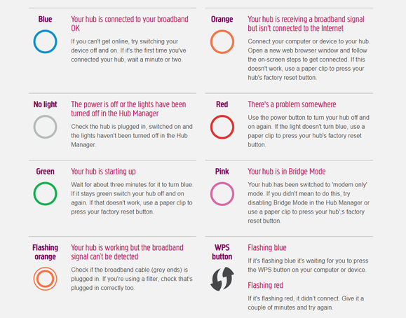

I thought the HUB2 light should be pink in bridge mode, are you sure its set up correctly.

Purple is no Internet connection.
I don’t know if this over rides pink.

Flashing Orange is no internet connection, pink which looks like purple is bridge mode

@Baldrick1  The OP has said the Hub2 works in router mode after a reset, so it looks like it is not being configured correctly for bridge mode.
Edit  Or as @Dan_the_Van says it may be the colour is not that obvious.🤔

Yes to confirm it is the solid Pink (more purple IMO!)
