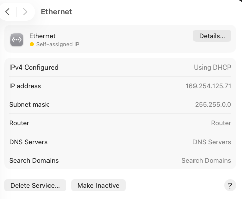

Thank you for your answer. I have my router directly connected to the ONT, so I am using it as Wireless Router Mode, and all the settings are ok, and the wifi works perfectly; however, the Ethernet network is still not working. I do not know if I have to add something to the router settings or to the computer (MacMini M1). I am adding pictures of the details that the connection shows:

It would seem that your MacMini isnt getting an IP address via DHCP. I would normally say to check that the DHCP server is enabled on the router but since wireless clients are working, that wouldn't seem to be the problem.

"Self-assigned IP"
This suggests the Mac Mini M1 is not connected to a network with a live DHCP sever or the DHCP server is OFF.
Are you connected directly to the AX73, have you blocked the device using the AX73 management screens or tether app?
You could try creating a manual IP Address on the M1, make sure you use an IP address in the routers network range.

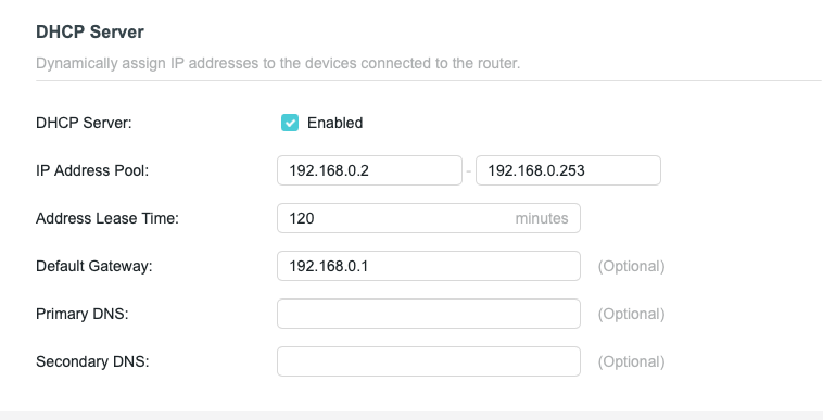

The DHCP is ON, see image below.

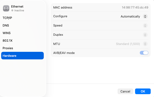

I set up a reserved IP for the Mac using the MAC address, see images below.

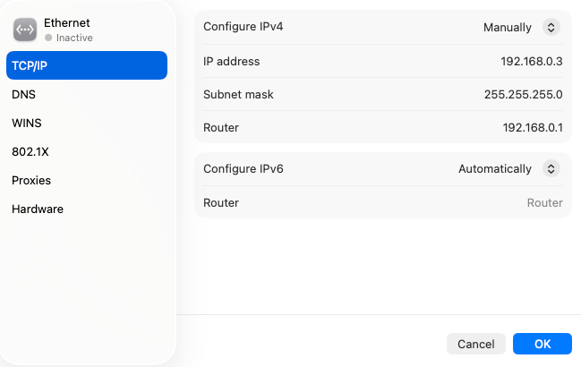

Then, I manually set up the IP on the Mac, see below.
After that, the Ethernet connection became green and shows "connected," but there is no internet connection, and the WiFi connection stops working on the Mac.
I do not know what else I have to try or if there is a mistake in any of the settings
Thank you again for your help.
If you set an IP address manually on the Mac, you probably also need to set the DNS server to the router IP ( 192.168.0.1 )

If you setup a IP Address reserve on the AX73 I would leave the MAC M1 to use DHCP, using DHCP will allow mobility between wired networks for the M1
Also turn off the WiFi interface on the M1 as it would not be required with a ethernet connection.
