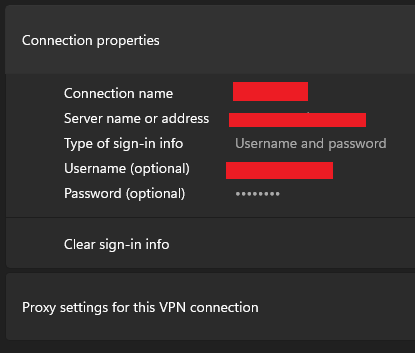

If you go into your Windows VPN settings, are you able to share the detail under 'Advanced Settings'? (feel free to private message me if you're not comfortable sharing here)

Not sure what information you're after, but I very much doubt Windows 11 Advanced Options will tell you anything useful.

It tells me that it differs to the native VPN conection on my own laptop that is using EAP authentication rather than the username and password you seem to be using.
Any proxy configuration?

No, there's no proxy.
