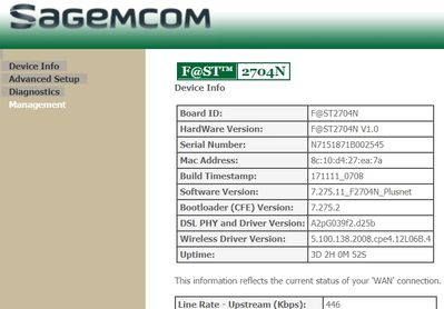

Helpdesk details:
1 - Product name: Plusnet Router
2 - Serial number: N7190191B001358
3 - Firmware version: 7.275.11_F2704N_Plusnet
4 - Board version: F@ST2704N
5 - Mode ADSL

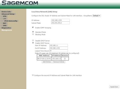

I have the same router, 7.275.11_F2704N_Plusnet (Hub 0?), and it does lose attached devices or forgets their names. After a router reboot all devices are usually there but they have dynamically assigned IP addresses. I made a copy of the device list and added friendly names for future reference.

For the Raspberry Pi I have set up a Windows Remote Desktop Connection (windows search rdp) to raspberrypi.local so I do not need to know its IP Address.
If you want to set fixed addresses you need to open http://dsldevice.lan/expert_user.html or http://192.168.1.254/expert_user.html Login <Advanced Setup> <LAN> Disable DHCP Server, click <Add Entries>, enter the MAC Address with desired IP Address (default is 192.168.1.n where 1<n>253). <Apply/Save>. I think a router restart is required for this to take effect.
  Disable DHCP Server
  Enable DHCP Server
       Start IP Address:
       End IP Address:
       Leased Time (hour):
       Static IP Lease List: (A maximum 32 entries can be configured)
MAC Address IP Address Remove
B8:27:EB:12:29:4C 192.168.1.4
If the router has not displayed the MAC address you can open a command prompt (windows search cmd) and ping the R/Pi (N.B. the '-4' means use IP v4).

As I said before, you need to login to the Expert User pages; what you show are the default Plusnet pages.
Just click one of these links:
Plusnet 2704N Expert UserPlusnet 2704N Expert User
Click:
[Advanced Setup]
Then
[LAN]
Plusnet 2704N Advanced  Setup LANPlusnet 2704N Advanced Setup LAN
Disable DHCP Server
Click [Add Entries]
Enter Desired MAC and IP Address
Click [Apply/Save]
Make sure o Enable DHCP Server is selected
Settings take effect after Reboot / Restart Router
(via Management page)
I think most would advise you to use your BT Home Hub.
Alan

Thanks Alan.
I confused: http://192.168.1.254/advanced_settings.html
with: http://192.168.1.254/expert_user.html
It is so annoying when the desire to be "user friendly" actually makes things "useful opaque".
Thank you again.  There does not seem to be an option for giving names to the fixed addresses.  On reboot, they get their broadcast names, but I will see if they are still there after a period, or they lose their names again.
