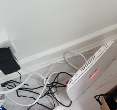

We had another drop out today where the router has gone 'red' again, so another complete drop out, is this still normal, im guessing it isn't?
