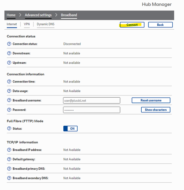

@MisterW wrote:
@bobpullen before we beat our heads against a brick wall here, are you aware of any reason why the FTTP variant of the BT Smart Hub 2 will not accept a PN username ?
Should be fine.
I would ignore any prompts to fiddle with port 4 cables/reconfigure/restart the hub.
The BT firmware will support operation in FTTP and non-FTTP mode. It will need to be configured in FTTP mode as per screengrab below.
When it is switched between modes, it may reset the PPP credentials when the changes are written to memory. Perhaps that is the issue here i.e. the port 4 prompt/restart is reverting the change that has been made to the username?

Re: Bt smart hub and disc on plusnet
This is an FTTP service so the SH2 needs to be in FTTP mode.
1. Disconnect all cables from the hub
2. Factory reset the hub by inserting something into the pinhole at the rear of the device until the status light flashes green
3. Once restarted, connect a device to the hub (preferably wirelessly) and then log into the GUI and navigate to Advanced > Broadband
4. Check the hub is in FTTP mode i.e. the toggle is 'ON'. If it is not, then enable it, accept the prompts and allow the hub to restart
5. Navigate back to the same page after the restart, ensuring the toggle is still set to 'ON'
6. Overwrite the username and password and click Connect (not much will happen)
7. Connect an ethernet cable beween LAN4/WAN and the LAN port on you ONT
8. Wait
After updating the username/password there should be nothing to Save, you just need to click Connect to store the connection credentials to memory.

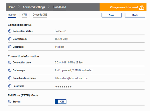

Seanbont
Posts: 16
Thanks: 4
Registered: ‎03-08-2023
Thanks Bob
The problem I have is that the connect option disappears as soon as you edit the Username and password.
https://community.plus.net/t5/media/gallerypage/user-id/123668/album-id/40630/image-id/43798i3359291...
It changes to save. Which then takes me to the restart page. Apologies if I'm missing a step or doing something wrong.
https://community.plus.net/t5/media/gallerypage/user-id/123668/album-id/40630/image-id/43799i4CD7EEE...
Then once I get through that process it resets the username back to btbroadband.
Where we live there is no mobile signal so the only connection is via our broadband. I've disconnected the new plusnet hub and the old bt hub all with no joy. The hub appears to be locked to btbroadband.
Sean
Posts: 20,181
Thanks: 9,099
Fixes: 581
@Seanbont that doesn't look like the page Bob posted above,  you need to go via the advanced settings I think ?
