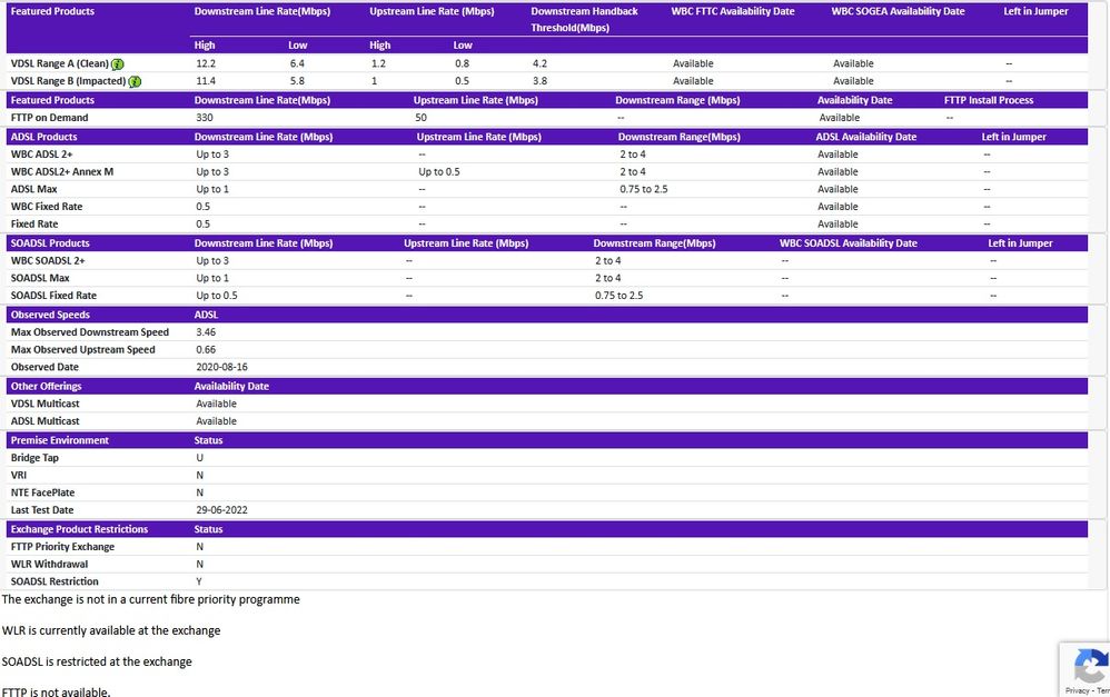

greygit
Posts: 196
Thanks: 20
Registered: ‎13-11-2021
Re: Potential STP (spanning tree) problem with Hub 2 when playing with some wirelessly connected dev
BT's assessment of the line attached. I'd anticipate that my line is assessed by BT as 'impacted'.
FTTPoD is apparently available, but FTTP is not available. That's interesting. The nearest fibre install is measured in miles. I suspect there's a wriggle clause or three that BT know about when it comes to FTTPoD,
Your comments re: saturation of upstream/uplink is correct. If traffic can't get out (gets dropped), then replies will not be coming back in. QoS on the local LAN has to have a modem/router that understands it. QoS settings on a customer's local connection/traffic will/should be ignored once the traffic exits into the upstream. Unless there is a financial arrangement between the customer and their upstream.
Posts: 24,668
Thanks: 8,800
Fixes: 377
@markhawkin The Broadband checker result provided after your post is slightly out of date - 2020, and I think the OP has said elsewhere that they are now on FTTC, although that is still providing an extremely low estimated max speed.
