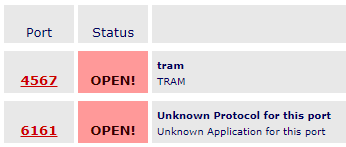

When checking the Hub One for open ports I found 4567 and 6161 open.
I think it was mentioned before that port 4567 may be open for TR-069 purposes. Does anyone know what port 6161 is listening for?

4567 is used for TR069/CWMP.
I'm not aware of port 6161 being open though, so suspect this is down to UPnP and another device on your local network.

Interesting. Can someone with a Hub One please check if their router's port 6161 is open on this site? https://www.yougetsignal.com/tools/open-ports/

6161 is open on my hub one. Can't be upnp.

Open on mine as well.

@bobpullen it would appear I'm not the only one with port 6161 open on the Hub One. Please can you find out what the router is listening on this port for?
Re: Ports 4567 and 6161 on Plusnet Hub One open
According to IANA (the port number registry) this is used for 'Patrol Internet Service Manager' does this mean anything to you?

@pv regarding the port 6161 observation, I've just jumped onto your router and it looks like it's related to the software framework embedded in the device that is used to underpin some of BT's diagnostic capability.
    (OR // Enabled remote admin services
      (AND // Remote telnet http
        IP_PROTO(TCP)
        (OR
          DST_PORT_RANGE(4567, 4567)
      (AND // BT SAAF
        IP_PROTO(TCP)
        DST_PORT_RANGE(6161, 6161)
I don't recall this being the case in the past mind you, so perhaps it's slipped in as part of the latest firmware deployment. I'll ask around.
In short: nothing to worry about.
Thanks, so Plusnet is not using port 6161 for anything? In which case maybe it would be worth closing this port in a future firmware update.
Did a spot of testing earlier. Seems it's been the case for at least the last four firmware revisions.
@pv, agreed. If it's not in use - we'll close it.

@pv, I've closed the port on your device so shout up if you notice any ill effects. We've requested this change is applied to the next firmware build that's deployed.
