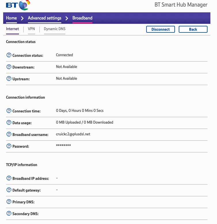

Attempted to change over to the Smart hub this morning,
Tried the Smart HUB 2 first, followed the procedure to the letter and when I connected the DSL (step 9 ) I tried to connect, Hub went through the process but it wouldn't connect.

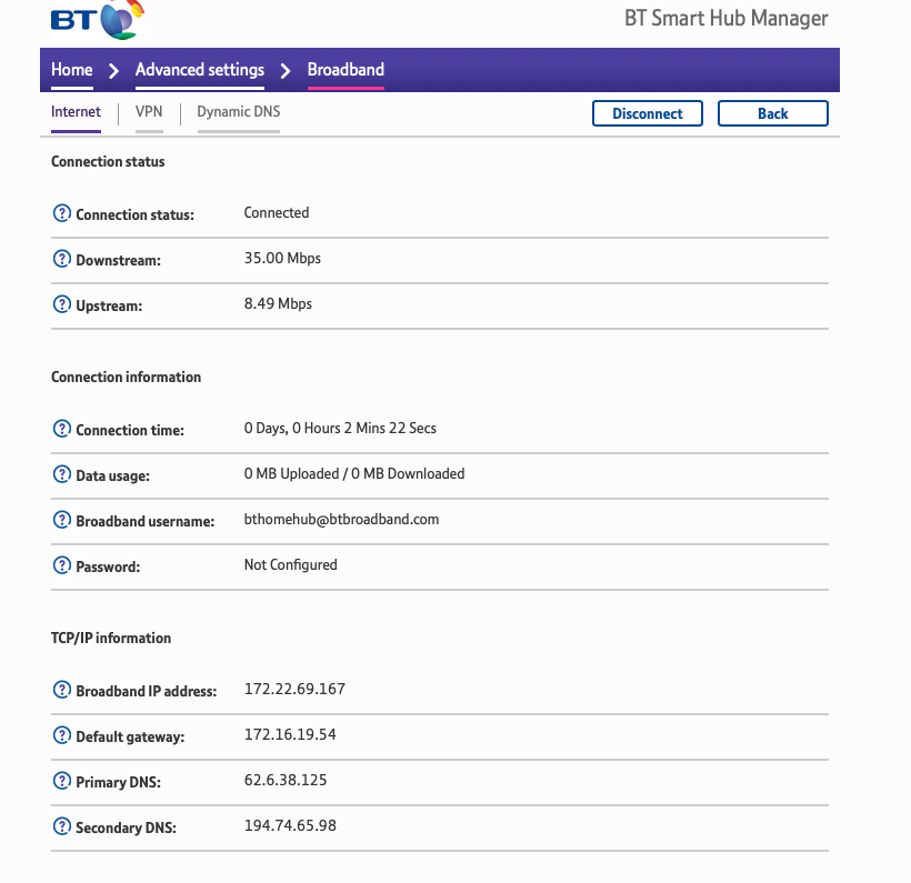

Tried the Smart Hub 6 got to step 9 and connected DSL and it hadn't connected automatically but I got distracted with something else and never tried to manually connect and after about 3 or 4 minutes the Hub automatically connected as per the screen shot
I left it alone for about 20 minutes as suggested to cary out firmware updates etc. When I returned I found that it hadn't actually connected under my Plusnet Broadband username but had connected under the default BT name.
There is no obvious save function for updating the Broadband name. There is  a reset name button which if pressed just re-inputs the BT Broadband username.
Possibly the Smart Hub 2 would also self connect if I had been a bit more patient but that also has no save function for the Broadband username so may have just done the same as the SH6.
