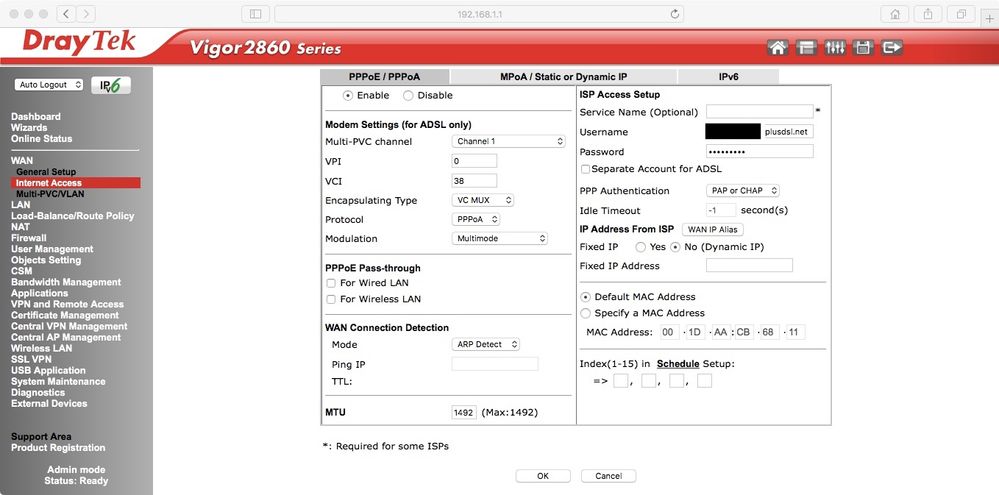

still nothing..... I've taken some grabs  see what you think.... Screen grab 1.jpegScreen grab 2.jpeg

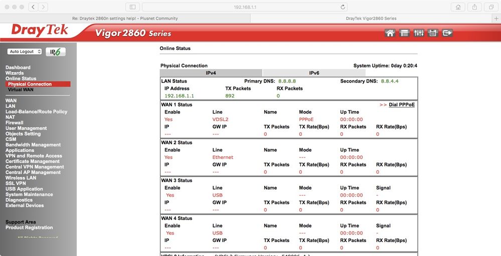

That looks fine to me , I've just compared it with my old config fro WAN1 on my 2830 when I was on ADSL and it looks the same. Only thing to check would be that you actually have WAN1 enabled. Can you post the screen from Online Status->Physical connection ? (assuming the menu is similar to the 2830)

Actually I've just notice that your settings have  "ARP Detect" for the WAN Connection Detection Mode - I have "PPP Detect" - that might make a difference?

screen grab from the online status

Thanks Corringham,
the drop down from ARP Detect only give me that or Ping Detect, then its wanting me to fill in an IP address etc. There is no option for PPP Detect.

Your WAN1 Physical Mode is showing as VDSL - I thought you were using ADSL?  Since you have the DSL Mode set to Auto it should detect which to use. So either it has it correct and you do in fact have a VDSL connection, and need the appropriate settings for that, or it has detected it wrongly and that s why it isn't working. In the latter case you could try changing the DSL MOde to "ADSL Only"
