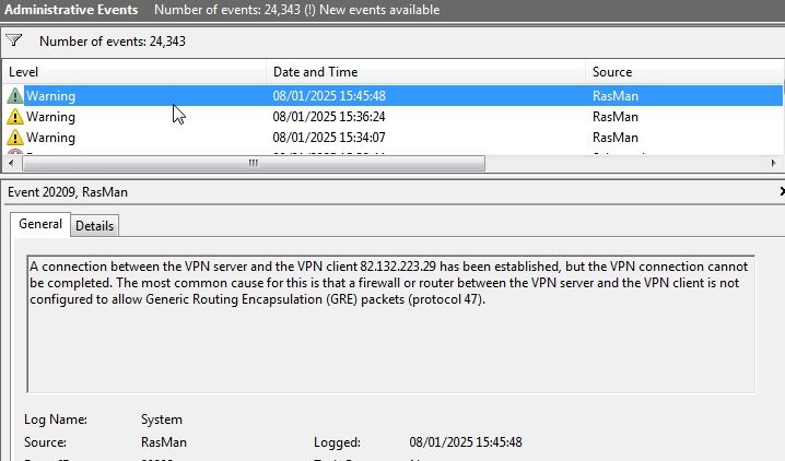

@bobpullen Well scratch that, your router is blocking traffic A_G_A_I_N.
Direct from the event viewer:
screenshot-1665screenshot-1665
The other night once I established that your device had decided to go by device name rather than the static-set IP address and reset it back to IP for port forwarding, I was able to connect my phone via vpn around 8 times. Obviously though, this was not away from home (which as previously noted, seems to be where the trouble starts).
Now today, I turn on the computer, go out with the missus, while we're out try to connect to the PC from my phone.. nothing. Repeated attempts.. nothing.
Get home, here we go, Windows itself is saying that the router is probably the fault. Yes, I've tried port clamping on the VPN page of the hub - no difference.
Kindly explain to me how the router decided to redirect ports to 'Atlanta' in the first place instead of 192.168.1.2 and how once discovered and updated, HOW IS IT BLOCKING ME YET AGAIN. Has someone at Plusnet HQ been remotely tinkering?

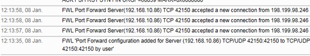

Not sure if it helps, I created a port forward rule 42150 TCP/UDP here are the log entries of the rule being created, also with me testing the the rule using https://www.yougetsignal.com/tools/open-ports/
What is significant of the above test I do not have any device which uses that port, the port checker fails but the Hub reports an accepted inbound connection.
A working port forward rule message would look identical but the port checker would show a successful connection.
I would really be helpful if the message included a NAK for when the destination IP Address is down or the connection failed.
