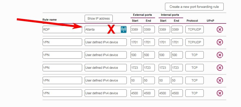

Right, your router IS at fault with a BUG that you have never discovered or corrected.
This:
screenshot-1661
Selecting the Device Name does not work - the router has (mysteriously) picked up it's VPN IP addresses (probably based on the Mac address) and has decided that using the machine name will do - data can be sent to the new IP which is wrong and not used by Windows to accept raw traffic. Windows accepts VPN encrypted traffic here.
So, it allows the first connection because it's pointing to 192.168.1.2. Then the router see's teh 210-215 IP address and points to that. Now it won't allow any normal traffic in because it's pointing there and will do so for X amount of time. Eventually, it will forget that IP and reset back to 192.168.1.2 - and then it will allow another connection again - and then lock onto the next IP in the 10 - 15 IP range - and so the cycle repeats. This now explains why I was getting one connection and then being blocked.
Using the actual IP address WORKS. I do vaguely remember now having some issue with this moons ago.
So your router has a bug. I use windows VPN which offers it's own IP addresses to connecting clients and it expects encrypted traffic. There is no point associating these IP addresses with that MAC and attempting to forward unencrypted data here as it does nothing.

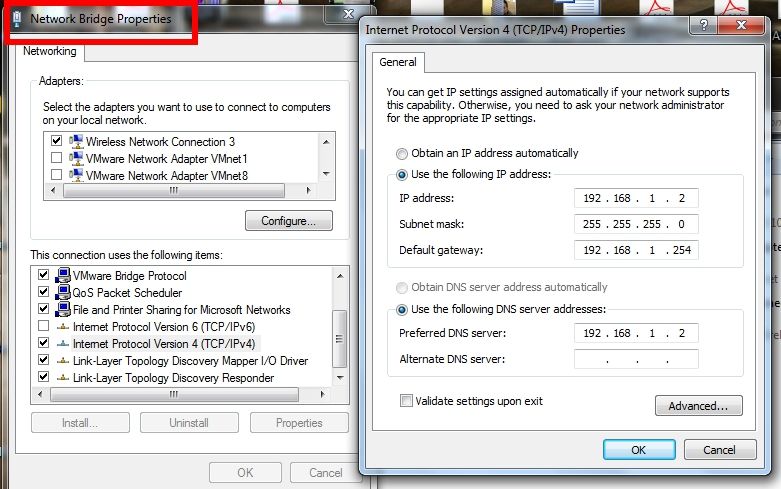

Network Bridge TCP/IP properties:
screenshot-1663
