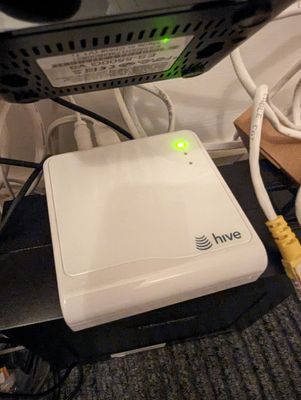

Would also be useful to know at what step things are failing.
I've just been to check on mine. I has a solid green light too and is working perfectly fine: -
