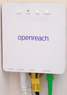

So for clarity i can get rid of the Huawei modem see image and connect direct to the Opnsense unit from ONT ( Optical Network Terminal) unit.
Yes!. Take the ethernet cable that currently goes from the Opnsense unit to the modem, disconnect it from the modem and connect it to the ONT. Job done! well not quite, switch off the modem, disconnect it from the line and dispose of it...

If you are having Full Fibre to your property you will get one of these installed
PORT is where you connect the OPNSense WAN connection removed from the Openreach modem LAN1 port,
There should be no need to change your plusnet broadband account details.
