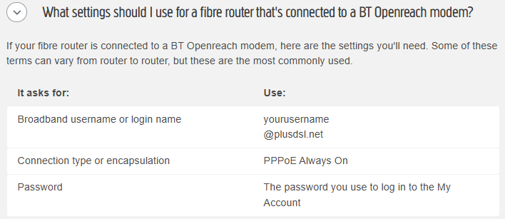

Re: New Hub Two delivered but i need to know how to set into modem mode only
@OsoPolar
You need these settings
The Openreach ONT can be seen as a modem, OPNsense is a router NO VLAN is required the ONT looks after that
But its currently not working when i connect !
So i am stuck in how to fix it with my current ADSL connection has worked for years
Soon as i plugin to the new ONT i lose all connections !
I really dont want to lose my Opnsense router as not a fan of the Hub2
