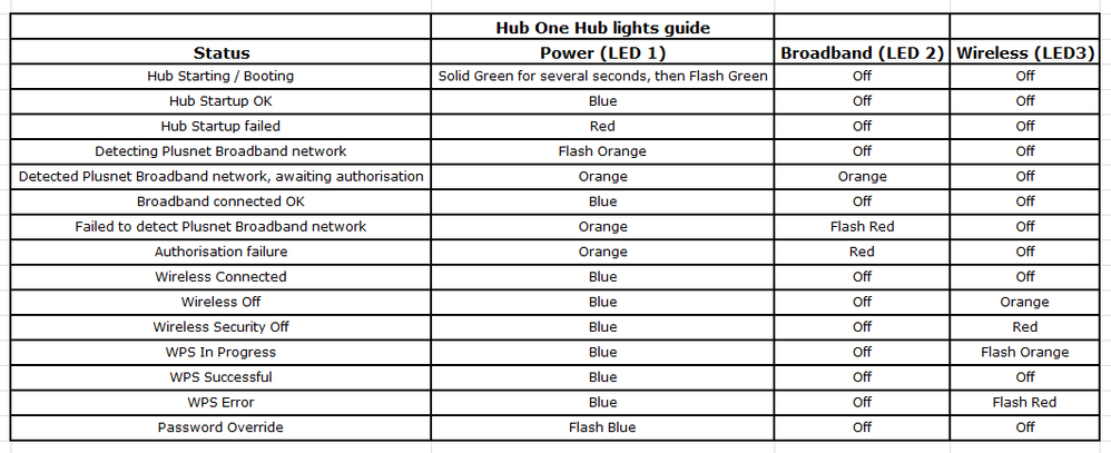

Posts: 5,004
Thanks: 3,313
Re: Moving from 2704N to Hub One
@DortonDoug
See above.
If its just the long LED flashing then the Hub One is failing to detect the PlusNet network, to me it suggests the Hub One supplied is defective.
