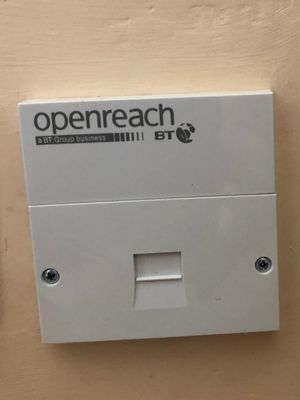

When you're able to set your Hub One back up again, could you take photos of the setup including hub and phone socket?
If you can post the photos here, we can double check things look okay.

Photos attached of the phone sockets, and the back of the Hub One.  I also have photos of the setup screens, if needed - just let me know.
Master socket is in the hall, extension socket in the study.  Hub One will not run off either socket; 2704N runs fine off the study socket.
Ethernet cable runs to desktop PC.

Thanks for the pictures, it looks like it should connect.
Have you tried taking the from cover off the Openreach master socket and plugging the ADSL filter in to the test socket?
You only need two wires connected between the master and extension sockets. Colours don't matter as long as they match up each end, you should see 2 and 5 with wires and they should be 2 to 2 and 5 to 5.
