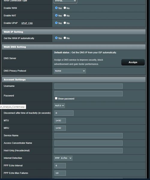

@Pedro78 wrote:
@RealAleMadrid, ok NOT the WAN port. Got it, thanks.
@MisterW  To enter those details, I need a DSL router, don't I?
No. The only thing that needs to have DSL capability is the modem (in this case, the Hub Two in bridge mode). The router behind it is irrelevant as it isn't responsible for establishing the DSL link with the local cabinet.
Why not take a look at the Asus WAN settings when you get a minute? Fairly certain you'll find an option for a PPPoE connection that has fields for entering a username and password.

@Pedro78  This thread seems to be going round in circles.
Look at section 4.3 WAN in this document Asus RT-AC59U User Guide
Wan Connection Type:  PPPoE
Authentication Drop down menu: One of the options will be username and password
That's all it needs.

Ok there's the settings! ,as well as the user/pass ect, there's a zillion other things, do I just leave them blank?

They're fine left at the defaults, just enter the username & password

That's the thing, no error messages...I've just realized though, the lights stayed blue AFTER I'd put it into bridge mode, according to PN's help page, they're meant to turn pink right?.
But anyways I put my username & pass into the correct fields and saved settings, people in this thread have said nothing else needs changing so I left everything else be. I plugged my router into port 1 on the Hub 2, nothing, tried port 2, nothing...rebooted everything, nothing. Router was in PPPoE mode I triple checked. As Hub 2 was in bridge, I couldn't access it so I factory reset to get it going again.

I'll try it again later, i 100% selected bridge mode then clicked saved, it even said "your settings are being saved, please wait" , When I refreshed the page, all the settings had disappeared and just the "Bridge mode" slider was there, set to ON. I'll try it again.
