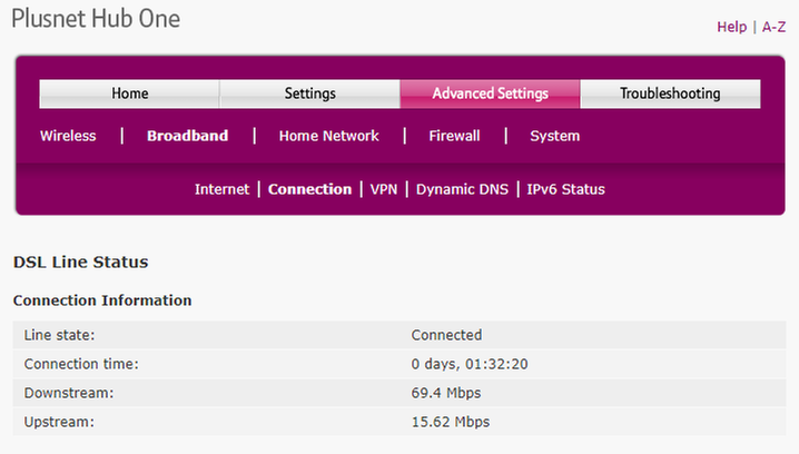

Nope, you aren't being thick - like a lot of people you just expect everything to work as it should, and I should have asked what your level of experience was.
Assuming you have a Hub1, if you access your routers home page and click the 'Troubleshooting' tab, that should open a page with a dialogue that starts with something like 'your adviser may ask you for this information' The picture below may help:-

I have copied the info' from helpdesk onto a word document and attached it. Hope this is what you are looking for. Thanks
Re: Mobile phones no longer connect to wifi
11-09-2021 1:51 PM
@Annie81 No word document, I'm afraid, but a screenshot would much more helpful, if possible, anyway.
until we can get your phones to 'find' your network, you won't be able to connect, despite @Baldrick1 's helpful advice.
11-09-2021 2:00 PM
Sorry, my laptop won't screenshot for some reason. Now on different laptop so hopefully should work.

11-09-2021 2:09 PM
It worked, @Annie81 , and proves there is nothing wrong with your routers setup - although I note both your 2.4 and 5ghz bands still have the same name.
