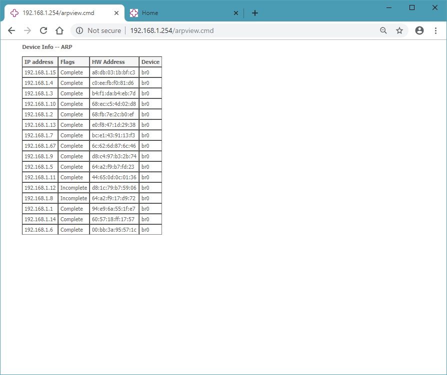

bobpullen
Posts: 17,113
Thanks: 5,400
Fixes: 330
Re: Is there a 12 device limit to connected devices.
@VinceMarsters, if there is one, I'm fairly certain it's not < 32/channel.
Regarding the originally reported issue with the Hub Zero. I failed to replicate it, and was able to successfully connect 13+ Wi-Fi devices to the router. I took a screenshot of the ARP table from the router at the time. I'll dig it out when I'm next in the office (on leave at the mo).
Edit:
