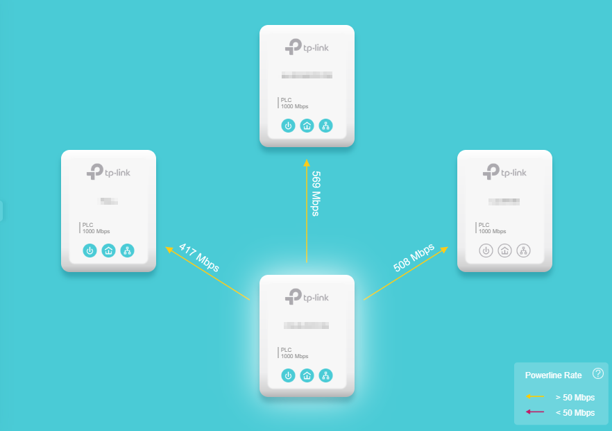

Powerline adaptors are quite often perfectly usable between circuits as long as you accept that you will likely only get around 60-120mbps (which is plenty for netflix and iplayer).  This is, of course, as long as the circuits are on the same consumer unit or a spur consumer unit that is fed off the main unit. The chances are that they will work well as long as you get a decent make.
If you go for a make with at least AV2 1000 and if you can afford it Range+ or similar where they can use 2 of 3 possible wires then I expect it will work rather well. I do and it does and I anlso have installed it for some number of friends and family and it is a perfectly good solution.  Don't necessarily believe the nay-sayers.
Get them from Amaz and return them if they don't work for you.  Keep all the packaging.  You can also then pop one behind the TV and use ethernet.  I happily stream UHD to my TV that is on a seperate circuit to the Router via Homeplugs using Ethernet leads and WiFi - No problem.
Sure - you will not get 130+Mbps but who cares!!  ps.  With homeplugs the point to point connection is always over 1 or 2 circuits (max) even if you have 5 circuits. Here is my stats for my plugs.  These are on 3 different circuits:
Now - these are the theoretical maximums of course.  As a rule of thumb if you 1/4 these figure this is the speed you will actually get as a throughput from point to point (if using ethernet) and less if using 2.4G (max 38Mbps). I get a constant 110Mbps from all points to all other points.
For my setup I got 2 sets of TP-Link TL-PA7027P KIT (4 in total) for £65 all in from fleabay.  Perfecto!!
If you wanted Wifi AP's in the mix then you would need the Wifi version of the kit (e.g. TL-WPA7617 KIT or TL-WPA8631P KIT - or whatever is the cheaper).   I would however stick to tp-Link or Devolo (imho).
