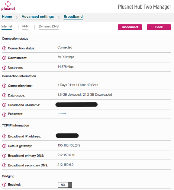

Posts: 4,997
Thanks: 3,306
Re: Hub swap
@Markwallwork0
As the Hub two does not appear to be on the management system, if you want to use it you can manually enter the broadband user name here
http://192.168.1.254 >Advanced settings >Broadband (admin password found on the removeable card)
The Hub needs to be in a disconnected state.
Broadband username is in the format [email protected]
The password is the same as the used in the members centre
HTH
