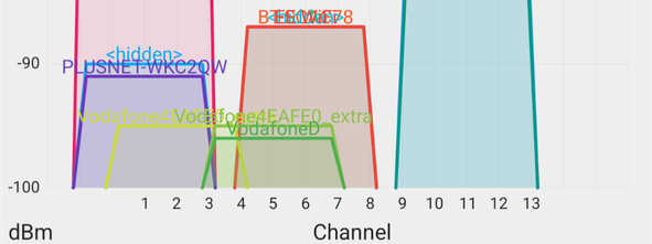

Here is an example.
Local WiFi to my location.
Vodafone4EAFE0_extra, the wifi is setup to use to have a 40 MHz channel width so is overlapping both Channel 1 and 6
VodafoneD with a 20 MHz channel overlapping 1 and 6.
Someone near me is also with plusnet.
