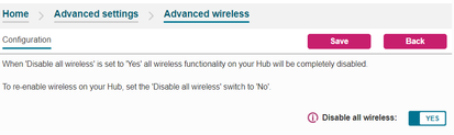

@jwsg
In Advanced Settings >Advanced Wireless you will see a new switch
The hidden networks are only turned off with this switch set to YES, switching off 2.4GHz or 5GHz separately does not switch the associated hidden network off.

Do the Tenda Mesh units support PPPoE connections? If yes then I would switching the Hub Two into bridge mode (modem only), I would use this method for the broadband connection, this will also turn off wireless.
With regards to the "Disable all" switch, a wireless sniffer may need to be refreshed or restarted to see the hidden networks go.
The Disable ALL switch does work
