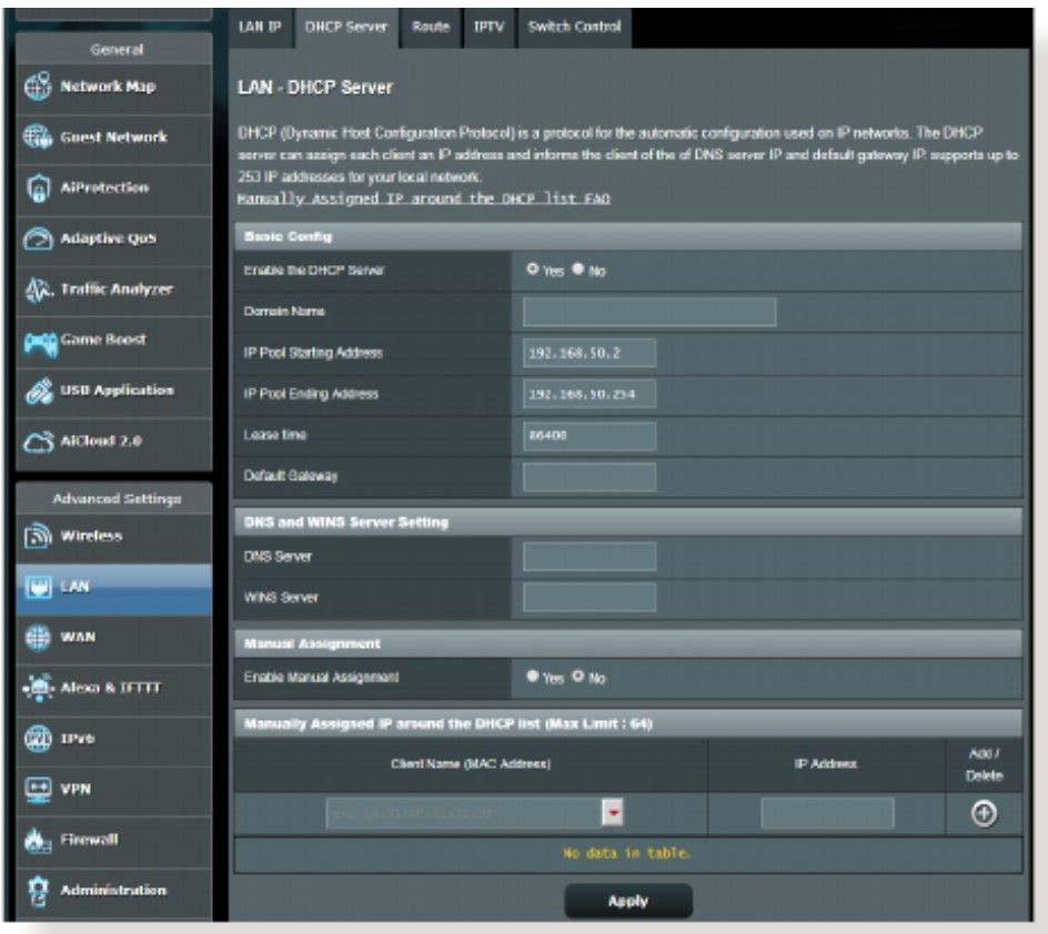

If it were me I wouldn't bother with these settings. All that you need to do is set the IP address in the suggested range on this page:
The subnet mask is correct.
Then switch off the DHCP server here:
That's it. When connecting it to your Plusnet hub try both the Asus WAN and LAN sockets.

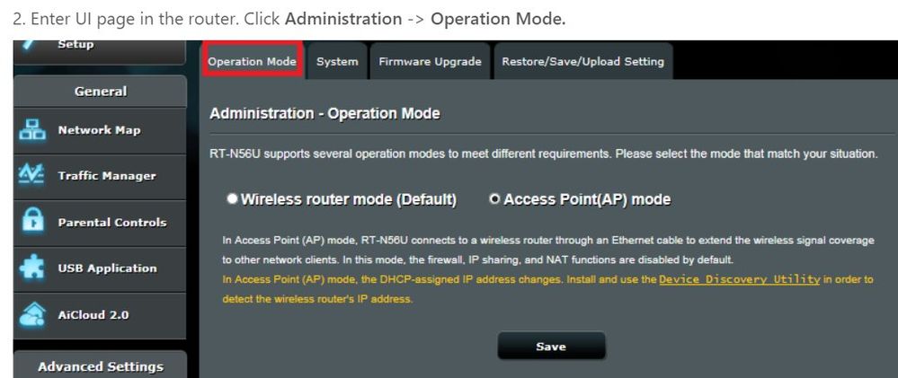

Glad that you are up and running. The reason that you lost contact with the Asus is because you changed its IP address. If you had put the new allocated IP address in to your browser it would have reconnected.
There's probably a way of getting it to work through the WAN socket if you go through the official route, but as I said, unless you are short of LAN sockets (you now have 6 available) then why bother.
Note that by using the Asus as an Access Point you lose the use of the other bells and whistles available if you connect it through a modem, but seeing that you are on ADSL there's probably little advantage.
