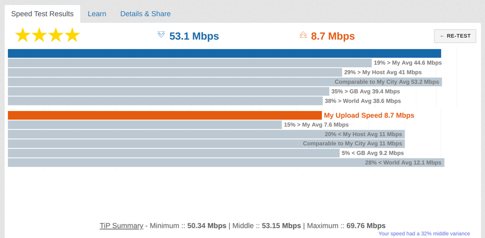

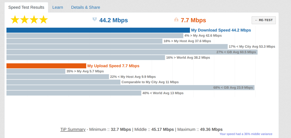

@DrWinstonOBoogi  I had exactly the same issues and @bobpullen  kindly did the upgrade for me, it was better, but  it was still flaky.
On Thursday night, I decided to replace my One hub with a BT hub6 and the Wifi issues are not such a problem, it's not 100%, but is almost seamless. So I'm thinking I need to look and make sure all the updates, to the other devices have been applied.
I just thought you might like to see the difference just switching hubs has made to my Fibre Extra speeds 😀  Who knows, one day my up speed may be in double digits and as high as 10mbps Funny
BTW - Plusnet just told me my line is "at its limit".  Maybe it just needs a reboot or resetting?
Plusnet One Hub (last week)Plusnet One Hub (last week)BT Hub6 (today)BT Hub6 (today)
