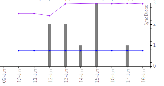

There are continuous dropout issues from the router.
Your line is dropping sync with the local cabinet. Unless this is you rebooting the router (grey bars), then you have an issue with your Internet connectivity that is completely unrelated to Wi-Fi.
