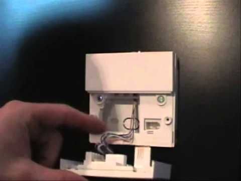

For some time now internal wiring faults down to customer, even though years ago may well have been installed by BT.
You need to use the Broadband Fault link as below.
To eliminate (internal wiring fault) you need to plug your router into the Test Socket on the BT/Openreach Master Socket...assuming you have one of course.
Remove the front part of the socket as image and plug router into socket showing on right Smiley
hqdefault

Hi, when I take off the front plate there doesn't seem to be a test socket behind it. I've looked online and the stuff behind the front plate on my master socket is not corresponding with everybody else's!

That is the latest type and your filter is plugged into the test socket. If the broadband doesn't work there it is a faulty router or a fault outside your premises so you shouldn't be charged.

Are you sure my filter is plugged into the test socket? All I did was take off the front plate and plug the filter into exactly the same socket as before only without the front plate attached. I thought the test socket was behind the frontplate to the bottom right so when I took off the front plate that's what I was expecting but, as I say, there was no other socket behind the front plate except the one that I'd plugged it into previously.

This is the latest NTE5c outlet. Two types of clip on front panels are available, a single telephone socket or a version with a built in filter and both ADSL and telephone sockets.
When you do your tests do not have anything connected into the filter telephone socket. The other potential problem is a faulty filter, do you have a spare you can try?

As I said before the filter is plugged into the test socket. It is the same socket that the front plate plugs into. There is no other socket.
