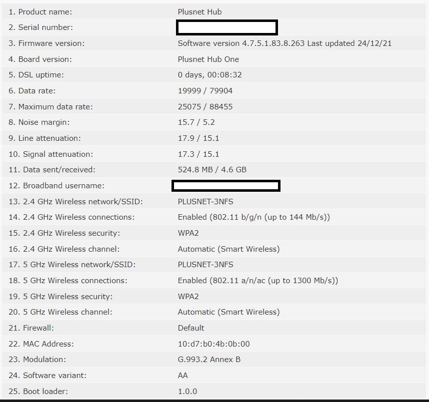

Some stats for you:
andyt1970
Posts: 302
Thanks: 15
Registered: ‎19-12-2019
Re: Fibre broadband keeps dropping, router light goes orange
New router was only plugged in last night, hence only this showing. Noticed firmware has been updated since using this new one too.

@andyt1970 Looking better - hope it stays that way. 👍 As to the F/W - ithat Help desk page says you are still on the buggy .263 version, the newest is .289.1.3

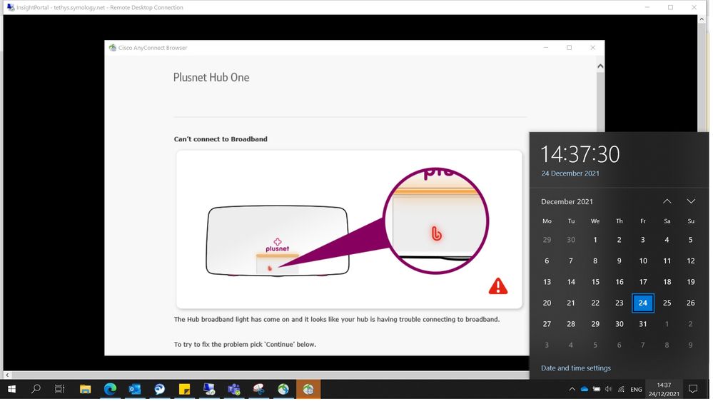

It's bad enough having to home work on Christmas Eve when my 5 year wants me to play with him and have fun, but to have a drop out after ALL OF THIS Sad
What's happening at 2.36pm?
