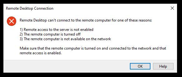

3 weeks of pure misery, constant disconnects and drop outs. Terrible wi-fi speeds and I can't do my job working from home Sad
I'm moving the router back upstairs tonight, back to my original set up as having the router downstairs plugged into a micro filter has made NO difference. Thanks Plusnet and BT Openreach. I won't be renewing come 31st March 2022.
Every time I get disconnected from my work, I have to wait 15 minutes as when I try to "log back on" due to being disconnected, it says "User already logged on" and there follows a 15 minute wait to get back on and work.
This is using the wi-fi from the router to connect my works laptop (upstairs in the lounge) and also my desktop PC (via the TP-Link RE220 Mesh Wi-Fi Range Extender) as I can't use ethernet anymore as the bl**dy router is now downstairs as advised by Plusnet AND BT Openreach.

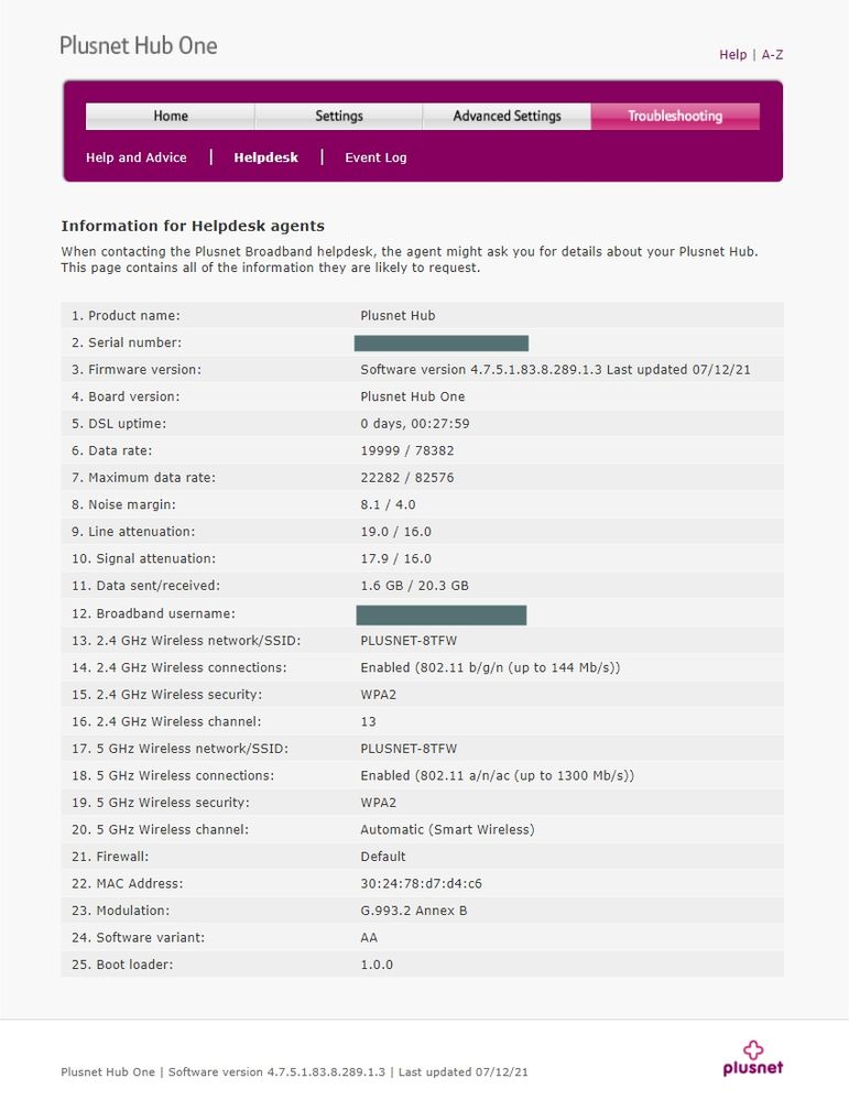

And this, whatever it means.
17:15:49, 09 Dec. (103708.750000) WAN operating mode is VDSL
17:15:49, 09 Dec. (103708.750000) Last WAN operating mode was VDSL
17:15:48, 09 Dec. (103707.240000) PPP IPCP Receive Configuration ACK
17:15:48, 09 Dec. (103707.240000) PPP IPCP Send Configuration Request
17:15:48, 09 Dec. (103707.230000) PPP IPCP Receive Configuration NAK
17:15:48, 09 Dec. (103707.230000) PPP IPCP Send Configuration ACK
17:15:48, 09 Dec. (103707.220000) PPP IPCP Receive Configuration Request
17:15:48, 09 Dec. (103707.200000) PPP IPCP Send Configuration Request
17:15:46, 09 Dec. (103705.900000) PPPoE is up -​ Down Rate=78382Kbps, Up Rate=19999Kbps; SNR Margin Down=3.8dB, Up=7.9dB
17:15:46, 09 Dec. (103705.880000) CHAP authentication successful
17:15:46, 09 Dec. (103705.800000) CHAP Receive Challenge
17:15:46, 09 Dec. (103705.800000) Starting CHAP authentication with peer
17:15:46, 09 Dec. (103705.790000) PPP LCP Receive Configuration ACK
17:15:46, 09 Dec. (103705.790000) PPP LCP Send Configuration Request
17:15:46, 09 Dec. (103705.780000) PPP LCP Receive Configuration Reject
17:15:46, 09 Dec. (103705.760000) PPP LCP Send Configuration ACK
17:15:46, 09 Dec. (103705.750000) PPP LCP Receive Configuration Request
17:15:46, 09 Dec. (103705.750000) PPP LCP Send Configuration Request
17:14:56, 09 Dec. (103655.780000) PTM over DSL is up
17:14:21, 09 Dec. (103620.300000) PTM over DSL is down after 4 minutes uptime
17:14:21, 09 Dec. (103620.290000) PPPoE is down after 3 minutes uptime [Waiting for Underlying Connection (WAN Ethernet 7 -​ Down)]
17:14:18, 09 Dec. (103617.160000) PPP LCP Send Termination Request [User request]
17:11:11, 09 Dec. (103430.750000) WAN operating mode is VDSL
17:11:11, 09 Dec. (103430.750000) Last WAN operating mode was VDSL
17:11:10, 09 Dec. (103429.270000) PPP IPCP Receive Configuration ACK
17:11:10, 09 Dec. (103429.260000) PPP IPCP Send Configuration Request
17:11:10, 09 Dec. (103429.250000) PPP IPCP Receive Configuration NAK
17:11:10, 09 Dec. (103429.250000) PPP IPCP Send Configuration ACK
17:11:10, 09 Dec. (103429.250000) PPP IPCP Receive Configuration Request
17:11:10, 09 Dec. (103429.230000) PPP IPCP Send Configuration Request
17:11:08, 09 Dec. (103427.940000) PPPoE is up -​ Down Rate=77365Kbps, Up Rate=19999Kbps; SNR Margin Down=3.1dB, Up=6.2dB
17:11:08, 09 Dec. (103427.920000) CHAP authentication successful
17:11:08, 09 Dec. (103427.880000) CHAP Receive Challenge
17:11:08, 09 Dec. (103427.870000) Starting CHAP authentication with peer
17:11:08, 09 Dec. (103427.870000) PPP LCP Receive Configuration ACK
17:11:08, 09 Dec. (103427.870000) PPP LCP Send Configuration Request
17:11:08, 09 Dec. (103427.860000) PPP LCP Receive Configuration Reject
17:11:08, 09 Dec. (103427.860000) PPP LCP Send Configuration ACK
17:11:08, 09 Dec. (103427.860000) PPP LCP Receive Configuration Request
17:11:08, 09 Dec. (103427.860000) PPP LCP Send Configuration Request
17:10:18, 09 Dec. (103377.640000) PTM over DSL is up
17:09:41, 09 Dec. (103340.920000) PTM over DSL is down after 0 minutes uptime
17:08:49, 09 Dec. (103288.200000) PTM over DSL is up
17:08:12, 09 Dec. (103251.550000) PTM over DSL is down after 0 minutes uptime
17:07:43, 09 Dec. (103222.250000) PTM over DSL is up
17:07:06, 09 Dec. (103185.890000) PTM over DSL is down after 16 minutes uptime
17:07:06, 09 Dec. (103185.890000) PPPoE is down after 15 minutes uptime [Waiting for Underlying Connection (WAN Ethernet 7 -​ Down)]
17:07:03, 09 Dec. (103182.840000) PPP LCP Send Termination Request [User request]
16:51:49, 09 Dec. (102268.310000) WAN operating mode is VDSL
16:51:49, 09 Dec. (102268.310000) Last WAN operating mode was VDSL
16:51:47, 09 Dec. (102266.610000) PPP IPCP Receive Configuration ACK
16:51:47, 09 Dec. (102266.600000) PPP IPCP Send Configuration Request
16:51:47, 09 Dec. (102266.570000) PPP IPCP Receive Configuration NAK
16:51:47, 09 Dec. (102266.570000) PPP IPCP Send Configuration ACK
16:51:47, 09 Dec. (102266.560000) PPP IPCP Receive Configuration Request
16:51:47, 09 Dec. (102266.530000) PPP IPCP Send Configuration Request
16:51:46, 09 Dec. (102265.090000) PPPoE is up -​ Down Rate=79904Kbps, Up Rate=19999Kbps; SNR Margin Down=3.5dB, Up=7.2dB
16:51:46, 09 Dec. (102265.070000) CHAP authentication successful
16:51:45, 09 Dec. (102265.040000) CHAP Receive Challenge
16:51:45, 09 Dec. (102265.040000) Starting CHAP authentication with peer
16:51:45, 09 Dec. (102265.040000) PPP LCP Receive Configuration ACK
16:51:45, 09 Dec. (102265.030000) PPP LCP Send Configuration Request
16:51:45, 09 Dec. (102265.030000) PPP LCP Receive Configuration Reject
16:51:45, 09 Dec. (102265.030000) PPP LCP Send Configuration ACK
16:51:45, 09 Dec. (102265.020000) PPP LCP Receive Configuration Request
16:51:45, 09 Dec. (102265.020000) PPP LCP Send Configuration Request
16:50:55, 09 Dec. (102214.980000) PTM over DSL is up
16:50:20, 09 Dec. (102179.670000) PTM over DSL is down after 87 minutes uptime
16:50:20, 09 Dec. (102179.670000) PPPoE is down after 86 minutes uptime [Waiting for Underlying Connection (WAN Ethernet 7 -​ Down)]
16:50:17, 09 Dec. (102176.700000) PPP LCP Send Termination Request [User request]
15:23:42, 09 Dec. (96981.090000) WAN operating mode is VDSL
15:23:42, 09 Dec. (96981.090000) Last WAN operating mode was VDSL
15:23:40, 09 Dec. (96979.740000) PPP IPCP Receive Configuration ACK
15:23:40, 09 Dec. (96979.730000) PPP IPCP Send Configuration Request
15:23:40, 09 Dec. (96979.720000) PPP IPCP Receive Configuration NAK
15:23:40, 09 Dec. (96979.720000) PPP IPCP Send Configuration ACK
15:23:40, 09 Dec. (96979.720000) PPP IPCP Receive Configuration Request
15:23:40, 09 Dec. (96979.700000) PPP IPCP Send Configuration Request
15:23:39, 09 Dec. (96978.510000) PPPoE is up -​ Down Rate=79904Kbps, Up Rate=19999Kbps; SNR Margin Down=3.4dB, Up=7.3dB
15:23:39, 09 Dec. (96978.500000) CHAP authentication successful
15:23:39, 09 Dec. (96978.460000) CHAP Receive Challenge
15:23:39, 09 Dec. (96978.460000) Starting CHAP authentication with peer
15:23:39, 09 Dec. (96978.460000) PPP LCP Receive Configuration ACK
15:23:39, 09 Dec. (96978.450000) PPP LCP Send Configuration Request
15:23:39, 09 Dec. (96978.450000) PPP LCP Receive Configuration Reject
15:23:39, 09 Dec. (96978.450000) PPP LCP Send Configuration ACK
15:23:39, 09 Dec. (96978.440000) PPP LCP Receive Configuration Request
15:23:39, 09 Dec. (96978.440000) PPP LCP Send Configuration Request
15:22:49, 09 Dec. (96928.760000) PTM over DSL is up
15:22:13, 09 Dec. (96892.550000) PTM over DSL is down after 6 minutes uptime
15:22:13, 09 Dec. (96892.550000) PPPoE is down after 5 minutes uptime [Waiting for Underlying Connection (WAN Ethernet 7 -​ Down)]
15:22:10, 09 Dec. (96889.610000) PPP LCP Send Termination Request [User request]
15:16:49, 09 Dec. (96568.200000) WAN operating mode is VDSL
15:16:49, 09 Dec. (96568.190000) Last WAN operating mode was VDSL
15:16:47, 09 Dec. (96566.780000) PPP IPCP Receive Configuration ACK
15:16:47, 09 Dec. (96566.770000) PPP IPCP Send Configuration Request
15:16:47, 09 Dec. (96566.760000) PPP IPCP Receive Configuration NAK
15:16:47, 09 Dec. (96566.760000) PPP IPCP Send Configuration ACK
15:16:47, 09 Dec. (96566.750000) PPP IPCP Receive Configuration Request
15:16:47, 09 Dec. (96566.740000) PPP IPCP Send Configuration Request
15:16:46, 09 Dec. (96565.520000) PPPoE is up -​ Down Rate=79904Kbps, Up Rate=19999Kbps; SNR Margin Down=3.3dB, Up=7.2dB
15:16:46, 09 Dec. (96565.510000) CHAP authentication successful
15:16:46, 09 Dec. (96565.460000) CHAP Receive Challenge
15:16:46, 09 Dec. (96565.460000) Starting CHAP authentication with peer
15:16:46, 09 Dec. (96565.450000) PPP LCP Receive Configuration ACK
15:16:46, 09 Dec. (96565.450000) PPP LCP Send Configuration Request
15:16:46, 09 Dec. (96565.450000) PPP LCP Receive Configuration Reject
15:16:46, 09 Dec. (96565.440000) PPP LCP Send Configuration ACK
15:16:46, 09 Dec. (96565.440000) PPP LCP Receive Configuration Request
15:16:46, 09 Dec. (96565.440000) PPP LCP Send Configuration Request
15:15:56, 09 Dec. (96515.800000) PTM over DSL is up
15:15:21, 09 Dec. (96480.560000) PTM over DSL is down after 108 minutes uptime
15:15:21, 09 Dec. (96480.560000) PPPoE is down after 107 minutes uptime [Waiting for Underlying Connection (WAN Ethernet 7 -​ Down)]
15:15:18, 09 Dec. (96477.540000) PPP LCP Send Termination Request [User request]
13:27:38, 09 Dec. (90017.900000) WAN operating mode is VDSL
13:27:38, 09 Dec. (90017.900000) Last WAN operating mode was VDSL
13:27:37, 09 Dec. (90016.700000) PPP IPCP Receive Configuration ACK
13:27:37, 09 Dec. (90016.700000) PPP IPCP Send Configuration Request
13:27:37, 09 Dec. (90016.690000) PPP IPCP Receive Configuration NAK
13:27:37, 09 Dec. (90016.690000) PPP IPCP Send Configuration ACK
13:27:37, 09 Dec. (90016.680000) PPP IPCP Receive Configuration Request
13:27:37, 09 Dec. (90016.680000) PPP IPCP Send Configuration Request
13:27:36, 09 Dec. (90015.630000) PPPoE is up -​ Down Rate=79904Kbps, Up Rate=19999Kbps; SNR Margin Down=3.4dB, Up=7.7dB
13:27:36, 09 Dec. (90015.620000) CHAP authentication successful

@andyt1970 Looking at that Help Desk shot, everything as far as the Hub is spot on, apart from the D/S noise margin which could be a little low, and also the uptime, which, unless you have turned the connection off very recently, indicates that you are loosing sync.
Unless you have turned it off, could you provide as much of the WAN tab on the Event log as possible?

I just posted it above, but it doesn't show Sad
andyt1970
Posts: 302
Thanks: 15
Registered: ‎19-12-2019
Re: Fibre broadband keeps dropping, router light goes orange
andyt1970
Posts: 302
Thanks: 15
13:27:36, 09 Dec. (90015.540000) CHAP Receive Challenge
13:27:36, 09 Dec. (90015.540000) Starting CHAP authentication with peer
13:27:36, 09 Dec. (90015.530000) PPP LCP Receive Configuration ACK
13:27:36, 09 Dec. (90015.530000) PPP LCP Send Configuration Request
13:27:36, 09 Dec. (90015.530000) PPP LCP Receive Configuration Reject
13:27:36, 09 Dec. (90015.520000) PPP LCP Send Configuration ACK
13:27:36, 09 Dec. (90015.520000) PPP LCP Receive Configuration Request
13:27:36, 09 Dec. (90015.520000) PPP LCP Send Configuration Request
13:26:47, 09 Dec. (89966.130000) PTM over DSL is up
13:26:12, 09 Dec. (89931.120000) PTM over DSL is down after 36 minutes uptime
13:26:12, 09 Dec. (89931.120000) PPPoE is down after 35 minutes uptime [Waiting for Underlying Connection (WAN Ethernet 7 -​ Down)]
13:26:09, 09 Dec. (89928.290000) PPP LCP Send Termination Request [User request]
12:50:48, 09 Dec. (87807.960000) WAN operating mode is VDSL
12:50:48, 09 Dec. (87807.960000) Last WAN operating mode was VDSL
12:50:47, 09 Dec. (87806.610000) PPP IPCP Receive Configuration ACK
12:50:47, 09 Dec. (87806.610000) PPP IPCP Send Configuration Request
12:50:47, 09 Dec. (87806.600000) PPP IPCP Receive Configuration NAK
12:50:47, 09 Dec. (87806.590000) PPP IPCP Send Configuration ACK
12:50:47, 09 Dec. (87806.590000) PPP IPCP Receive Configuration Request
12:50:47, 09 Dec. (87806.590000) PPP IPCP Send Configuration Request
12:50:46, 09 Dec. (87805.430000) PPPoE is up -​ Down Rate=79904Kbps, Up Rate=19999Kbps; SNR Margin Down=3.4dB, Up=7.3dB
12:50:46, 09 Dec. (87805.410000) CHAP authentication successful
12:50:46, 09 Dec. (87805.370000) CHAP Receive Challenge
12:50:46, 09 Dec. (87805.370000) Starting CHAP authentication with peer
12:50:46, 09 Dec. (87805.360000) PPP LCP Receive Configuration ACK
12:50:46, 09 Dec. (87805.360000) PPP LCP Send Configuration Request
12:50:46, 09 Dec. (87805.360000) PPP LCP Receive Configuration Reject
12:50:46, 09 Dec. (87805.360000) PPP LCP Send Configuration ACK
12:50:46, 09 Dec. (87805.350000) PPP LCP Receive Configuration Request
12:50:46, 09 Dec. (87805.350000) PPP LCP Send Configuration Request
12:49:56, 09 Dec. (87755.670000) PTM over DSL is up
12:49:21, 09 Dec. (87720.170000) PTM over DSL is down after 178 minutes uptime
12:49:21, 09 Dec. (87720.170000) PPPoE is down after 177 minutes uptime [Waiting for Underlying Connection (WAN Ethernet 7 -​ Down)]
12:49:18, 09 Dec. (87717.230000) PPP LCP Send Termination Request [User request]
09:51:27, 09 Dec. (77048.010000) WAN operating mode is VDSL
09:51:27, 09 Dec. (77048.010000) Last WAN operating mode was VDSL
09:51:26, 09 Dec. (77046.800000) PPP IPCP Receive Configuration ACK
09:51:26, 09 Dec. (77046.790000) PPP IPCP Send Configuration Request
09:51:26, 09 Dec. (77046.780000) PPP IPCP Receive Configuration NAK
09:51:26, 09 Dec. (77046.780000) PPP IPCP Send Configuration ACK
09:51:26, 09 Dec. (77046.780000) PPP IPCP Receive Configuration Request
09:51:26, 09 Dec. (77046.780000) PPP IPCP Send Configuration Request
09:51:25, 09 Dec. (77045.730000) PPPoE is up -​ Down Rate=79904Kbps, Up Rate=19999Kbps; SNR Margin Down=3.6dB, Up=7.3dB
09:51:25, 09 Dec. (77045.720000) CHAP authentication successful
09:51:24, 09 Dec. (77045.670000) CHAP Receive Challenge
09:51:24, 09 Dec. (77045.660000) Starting CHAP authentication with peer
09:51:24, 09 Dec. (77045.660000) PPP LCP Receive Configuration ACK
09:51:24, 09 Dec. (77045.660000) PPP LCP Send Configuration Request
09:51:24, 09 Dec. (77045.650000) PPP LCP Receive Configuration Reject
09:51:24, 09 Dec. (77045.650000) PPP LCP Send Configuration ACK
09:51:24, 09 Dec. (77045.650000) PPP LCP Receive Configuration Request
09:51:24, 09 Dec. (77045.650000) PPP LCP Send Configuration Request
09:50:35, 09 Dec. (76996.270000) PTM over DSL is up
09:50:00, 09 Dec. (76961.250000) PTM over DSL is down after 35 minutes uptime
09:50:00, 09 Dec. (76961.250000) PPPoE is down after 34 minutes uptime [Waiting for Underlying Connection (WAN Ethernet 7 -​ Down)]
09:49:57, 09 Dec. (76958.390000) PPP LCP Send Termination Request [User request]
09:15:03, 09 Dec. (74863.750000) WAN operating mode is VDSL
09:15:03, 09 Dec. (74863.750000) Last WAN operating mode was VDSL
09:15:01, 09 Dec. (74862.500000) PPP IPCP Receive Configuration ACK
09:15:01, 09 Dec. (74862.500000) PPP IPCP Send Configuration Request
09:15:01, 09 Dec. (74862.490000) PPP IPCP Receive Configuration NAK
09:15:01, 09 Dec. (74862.490000) PPP IPCP Send Configuration ACK
09:15:01, 09 Dec. (74862.480000) PPP IPCP Receive Configuration Request
09:15:01, 09 Dec. (74862.480000) PPP IPCP Send Configuration Request
09:15:00, 09 Dec. (74861.410000) PPPoE is up -​ Down Rate=79904Kbps, Up Rate=19999Kbps; SNR Margin Down=3.6dB, Up=7.2dB
09:15:00, 09 Dec. (74861.390000) CHAP authentication successful
09:15:00, 09 Dec. (74861.360000) CHAP Receive Challenge
09:15:00, 09 Dec. (74861.350000) Starting CHAP authentication with peer
09:15:00, 09 Dec. (74861.350000) PPP LCP Receive Configuration ACK
09:15:00, 09 Dec. (74861.350000) PPP LCP Send Configuration Request
09:15:00, 09 Dec. (74861.340000) PPP LCP Receive Configuration Reject
09:15:00, 09 Dec. (74861.340000) PPP LCP Send Configuration ACK
09:15:00, 09 Dec. (74861.340000) PPP LCP Receive Configuration Request
09:15:00, 09 Dec. (74861.340000) PPP LCP Send Configuration Request
09:14:11, 09 Dec. (74811.850000) PTM over DSL is up
09:13:36, 09 Dec. (74776.700000) PTM over DSL is down after 179 minutes uptime

WHY WON'T IT LET ME PASTE ALL 3 "PAGES" OF DATA?
Posts: 25,231
Thanks: 9,123
Fixes: 387
Thanks Andy, whatever PN/BT are telling you, there is something wrong with the connection before your Hub, which needs a proper investigation - where you have the Hub will have no effect on the PPPoE connection.
Don't worry, Andy, there is more than enough there to warrant a proper investigation of the BT infrastructure.
