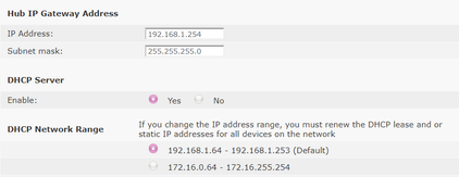

Hi @Dan_the_Van ,
Yes it has a single range for DHCP (if that's what you meant?)
I've attached a screenshot...
Posts: 4,243
Thanks: 2,546
Fixes: 124
Re: Failing to obtain IP address from DHCP - is 25 devices too many for PlusNet hub?
@dabevan
Some wireless repeaters also have a DHCP server.
Are the devices not getting an IP Address 2.4GHz only devices? As there issues with some routers with devices struggling to get IP Address/connection where the SSID for 2.4 and 5GHz share the same name. A solution for this would be rename the 5GHz signal name by appending -5 to the name.
