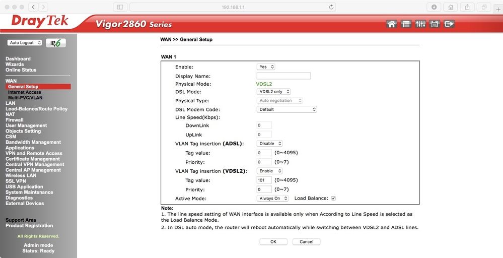

Being optimistic, lets assume it is in fact VDSL (that's FTTC) - the required settings (from the Plusnet help page) are:
Broadband username or login name yourusername@plusdsl.net
Connection type or encapsulation PPPoE Always On
Password The password you use to log in to the Member Centre
VLAN Active
VLAN ID (802.1q) 101
VLAN ID (802.1p) 0
give that a go and see what happens...
Edit: just to be clear, the 101 should go into the VSDL tag value field

Can you repost those last 2 screens now that you've changed the settings

BINGO!!!!
id put the last setting into the wrong box.
Working now!!!
Thanks for all your help!

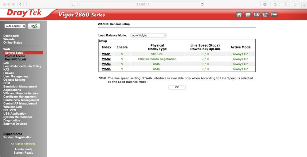

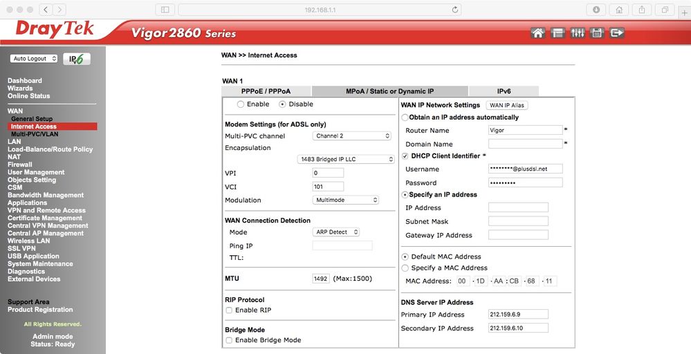

Screen Grabs as promised.
Ive blanked out my username / password etc.
Hope it helps someone.
Thanks again its all working a treat Wink
