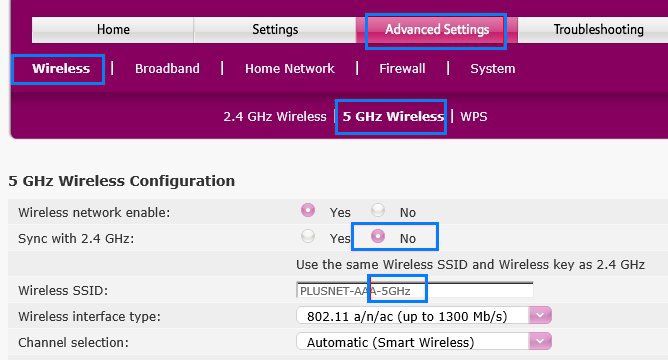

You need to split the 2.4 and 5 GHz wireless networks as what you describe is a known issue when using Apple devices with the Hub One.
On a web browser, go to    192.168.1.254   and log into it.
Then navigate to the 5 GHz wireless page shown below
Edit the Wireless SSID by for example appending '-5GHz' to the end of the name.
Now configure your IOS devices to connect to the new 5 GHz wireless SSID.

Thank you 😊
I've changed the settings and so far all working fine, internet speed also much better on iPads now.
