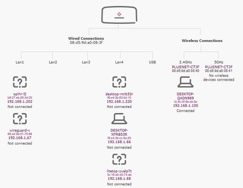

I have connected my Hub One to a PPPoE server so it has a live WAN connection
The Home page only shows connected devices.
>Advanced settings >Home network >Devices shows this
These devices are also show in the DHCP table.

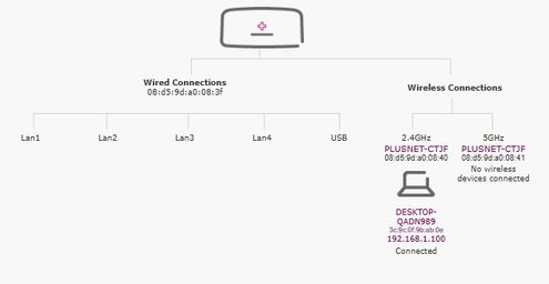

I used the Refresh button, with this result.
The DHCP Table now only shows one device.
I have four TAPO P100 smart plugs who all have the same hostname on my live network.
Hope this helps.
EDIT: reconnecting devices will receive the same IP Address previously allocated to them last time they connected.

In your first picture, you don't really have two devices simultaneously connected with the same name, as "Desktop-NTRB53R" is upper case for one and lower case for the other.
I can see that you have devices showing as "not connected", at least until you hit refresh. I must admit I dob't recall seeing this on my router, and as it typically does an automatic refresh as soon as I display the home network>Devices screen, I am not sure how you managed to get this screen capture. Are you running the same firmware as I am?
But - now that you have disconnected devices that are no longer visible in the home network>Devices screen, would your Hub1 now allow you to connect a new device and call it (for example) opihr-II?
Regarding your TAPO smart plugs, unless I am mistaken they do not appear in the screenshots. Are you able to show me how these appear either in the DHCP table of on home network>devices, with the same network hostname?
