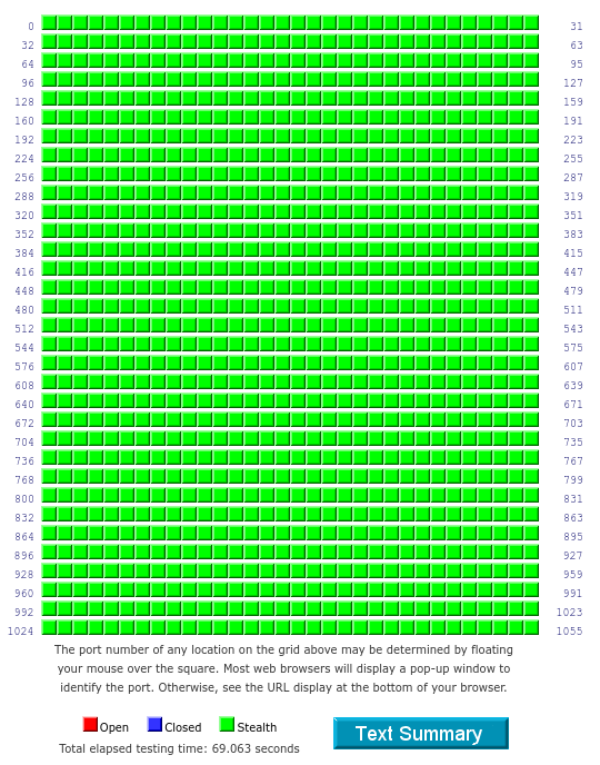

If you want to check if you have any router ports exposed to the internet, you could run a port scanner such as ShieldsUP!
Browse to GRC ShieldsUP!
Click on the grey [Proceed] button
Click on grey button [All Service Ports] (in the middle of the screen)
... let the test run, and hopefully you should see an all green results array
Note that if any ports are not green, then you can hover your cursor over that box to see what port isn't stealthed.
Looks like I am good to go. Smiley
