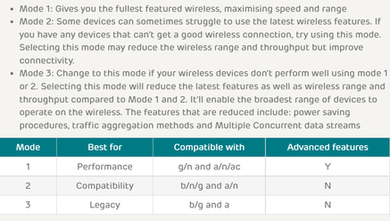

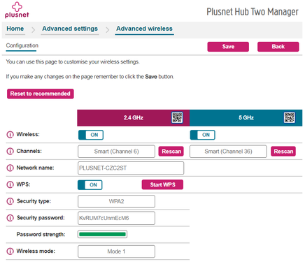

Did you try making the Hub Two Wireless network name (SSID) the same as the Hub One?
Within the settings of the Hub Two wireless network is the ability to change the mode, the default being one.
It might work, worth a try

Thanks for the warning about the password, currently the Hub Two is operating in 'Bridge Mode' so Wireless is turned off.

This did the trick. Setting router to mode 3 enabled the cctv to pick it up, then upped it back to mode 1 and they remained connected. Thanks
