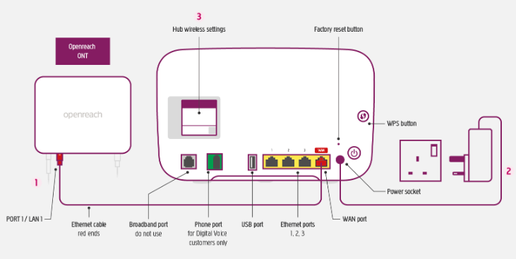

This is how you connect a Hub two to the ONT.
You can replace the Hub Two with your choice of router, in your case you mentioned TP-Link devices.
There is no need for a switch between the ONT, your router as connected directly to the ONT using the WAN port.
Any wired mesh system is connected to the router making the PPPoE connection using one of it's LAN ports.
HTH

Not that I'm trying to be argumentative, where does it say in the Hub Two helpful guide to put the Hub into bridge mode?.
If you are the slightest bit technical connecting the ONT to a WAN port of a router would to me suggest the ONT is a modem, connecting a router to a router would introduce double-NAT and why would any ISP want that?
