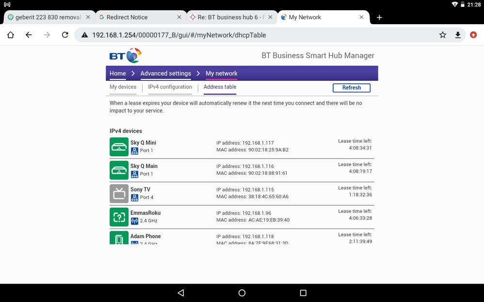

On a slightly different note, not sure if this is the hub or not, but it just refuses to stay connected to my smart TV via ethernet. It connects, and after around a day or so, decides the TV is disconnected and TV just reports ethernet disconnected when it is connected. No matter what I try with TV, reboots etc it will not regain a connection unless I reboot router. It's done it again tonight, TV reporting ethernet disconnected. I've swapped ports, from 4 to 2, but hub hasn't recognised this, and TV not connected. TV is a Sony android TV, nothing on Sony forums about this. Anyone any ideas... Only thing I could possibly try is putty the hub 1 back on the network, ask don't actually recall it happening with the hub 1,but i may be mistaken.... An excerpt from LAN logs, and there is much more of this seen....

It's also still got lease time left, it's set to 5 days, and currently connected to port 2,but router has failed to recognise this

Have you tried a different Ethernet lead?

No. Didn't think of this, as I got 3 all brand new when I swapped from hub 1 to hub 6. 1 goes to sky q, 1 to a powerline adapter, the other to the TV. They are all 3m cat6 cables. Will try the cable originally connected. Is it possible the TV doesn't like Cat 6

Changed ethernet cable. TV was off when changed. On starting the TV, router still thinks it's connected to port 4 when it's actually connected to port 2. Restarting the TV had no effect. Rebooted router, everything ok again.
It's odd that all other devices on ethernet work, which rather points to the TV, but I would have thought restarting TV would have cured that. Anyhow will see what happens over the next couple of days, if same thing happens,I'll temporary swap back to the hubq, which I am sure didn't have this issue, but not 100%sure, but it was connected by ethernet to the hub 1.

I suspect it's a DHCP lease renew problem. To prove it, you could try giving the TV a static IP. Assuming the Hub 2 is using defaults, then use an IP address in the range 192.168.1.1 - 192.168.1.63 , subnet mask 255.255.255.0 and default gateway 192.168.1.254

Thanks for the thoughts. Its a BT business hub 6, that appears to be playing up, replaced the Hub 1, due to poor wireless performance.
It is however using the default DHCP assignments.
I did try this when it had failed once, and I was getting the Ethernet not connected message, but it didnt work, which I assume was due to the fact the BT hub still thought a device with the same MAC was still active???.  I will try if it fails again, once the router has been rebooted.
Odd that no other device on ethernet has this issue. The TV is in standby when not used, Sky boxes go into a deep sleep during the night, and the powerline adapter is switched off when not being used.
