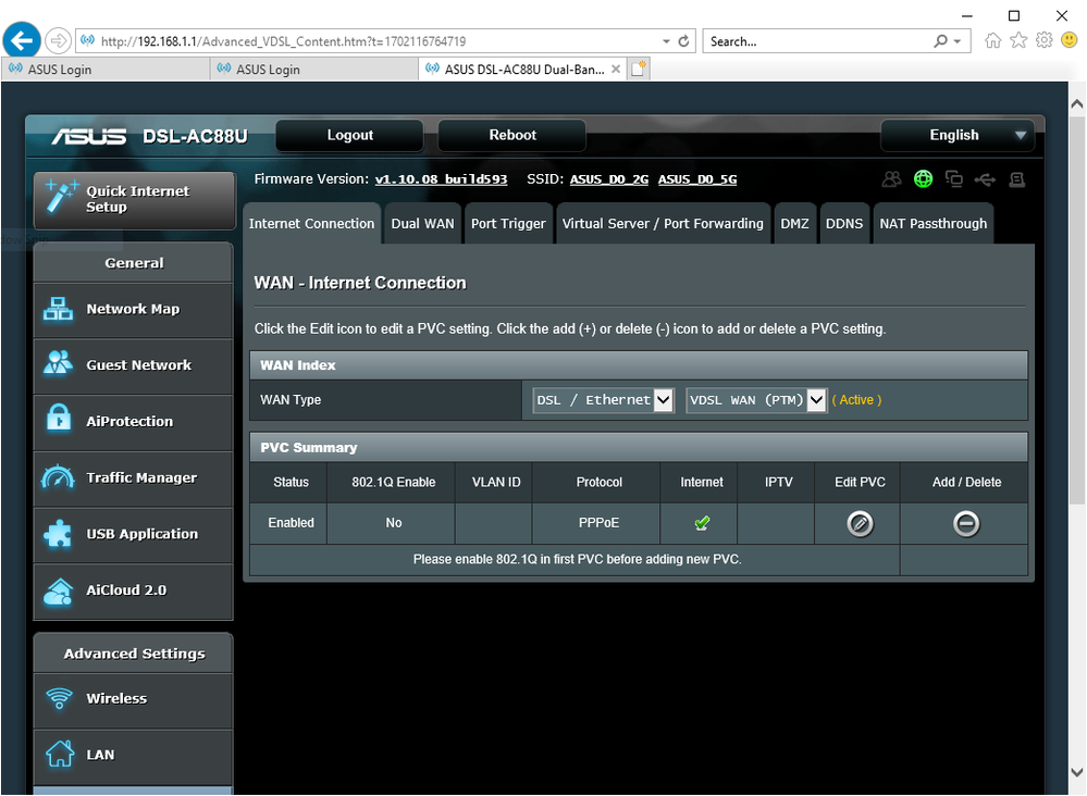

This picture shows WAN type VDSL and says active! Im using ADSL (also shows PPPoE which is not correct according to Plusnet)

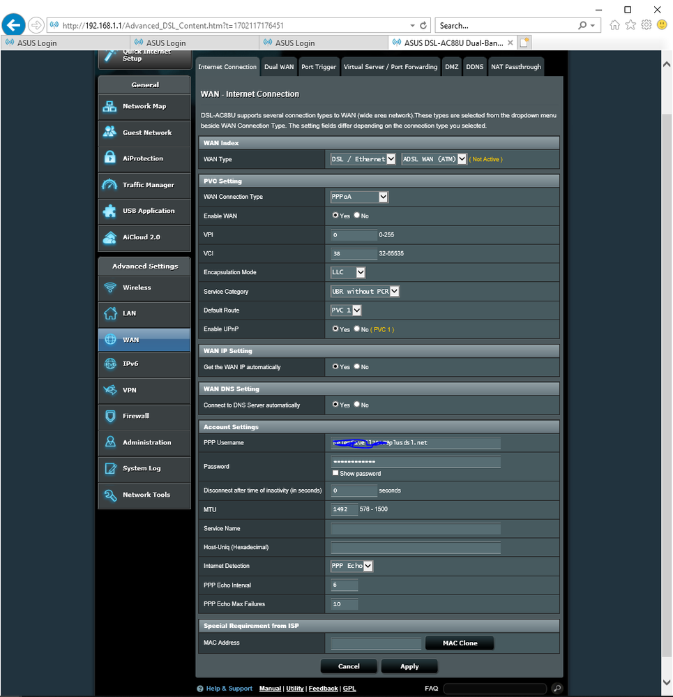

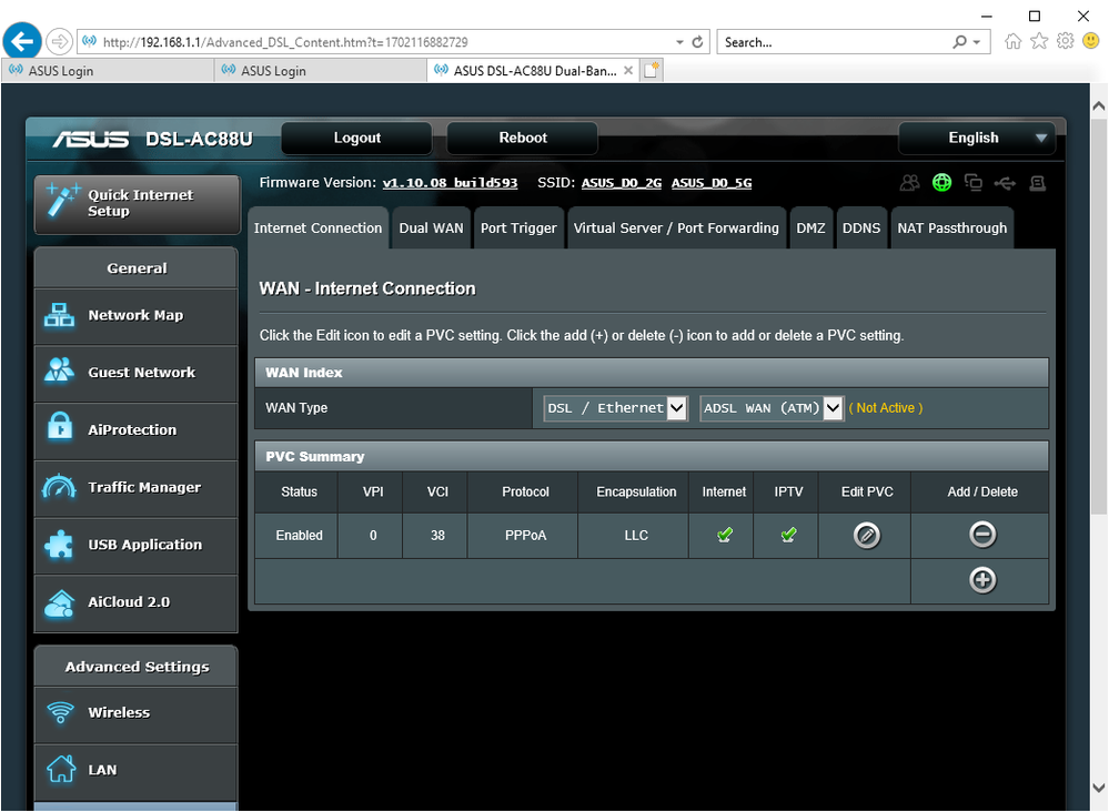

This picture shows WAN type ADSL and says Not active and shows PPPoA which is correctCapture 2.PNGCapture 2.PNG
ADSL settings

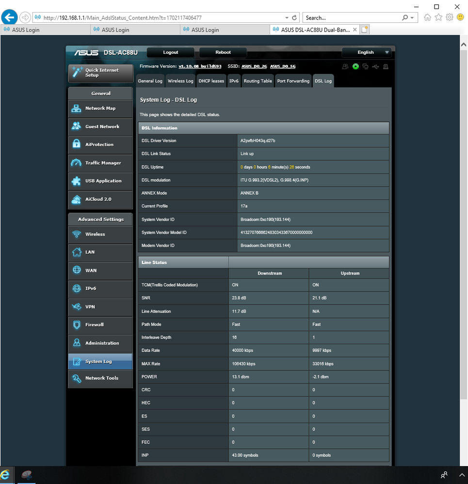

DSL log

@1of1stuff Your encapsulation is showing as LLC , it should be VC-MUX
Also, I suspect there is two WAN interfaces created by default a VDSL one and an ADSL one.
Can I just check what Plusnet product you are on , to make sure that ADSL is the correct setting ?

This is confusing, the last screen shot show DSL modulation being VDSL2, Annex B,  Data rate of 40000 / 9997 kbps
Edit: the first screen shot shows VDSL as Active with the second showing ADSL as Not Active.

@Dan_the_Van yes, very confusing, it does look like @1of1stuff is on a VDSL (FTTC) connection.
In which case the problem will be that 802.1Q is disabled in the VDSL settings, it needs to be set to Enabled and the VLAN ID set to 101

@1of1stuff ok, so you are on FTTC (Fibre to the cabinet) , which still uses the copper line for the 'last mile' from the cabinet to your house. This uses VDSL ( Very high speed Digital Subscriber line) modulation as opposed to ADSL to give a higher speed connection.
You router has automatically detected that it has a VDSL signal but you are not getting an internet connection beause of the lack of VLAN ID. Setting 802.1Q to enabled and the VLAN ID to 101 should get it working.
