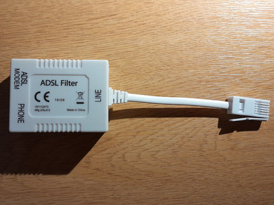

I don't think I have the filter that came with the Hub 2, but I do have what I believe is an older one, marked ADSL Filter, with the attached Line lead ending in a telephone plug. If that is the right type for the test socket, I'll give it a go.

My Googling suggests that the test socket is a telephone-type, so I'm going to try the filter I have, reconnect the Hub 2, and see what happens...
LATER
Result! With the filter in the test socket and the original cable connecting it to the Hub 2, my speeds are back up to 56.2 / 17.1 Mbps.
So clearly the fault lies in the front-plate connector. Should I replace it, or is it OK simply to leave everything as it is for now?

That filter will work as the test socket is a telephone one.
