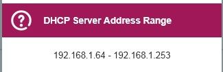

greygit1
Posts: 411
Thanks: 57
Registered: ‎26-06-2023
Re: Accessing Snom VOIP base station through Hub Two
